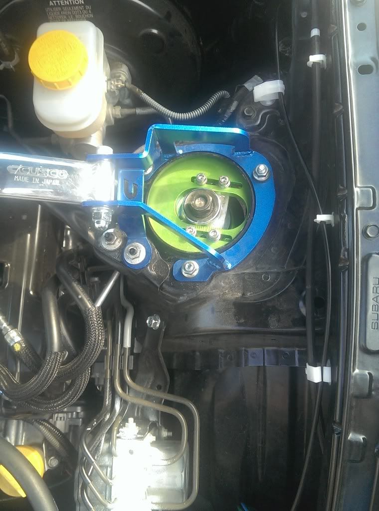

Scalzo 05-31-2013 06:07 PM
Here's what driver side looks like
http://i1297.photobucket.com/albums/...ps56415f64.jpg

2point0 05-31-2013 06:30 PM
Yeah, that doesn't look right. No way would you want to have all that adjustability towards the positive...at least not for any reason I can think of.
Racecomp Engineering 05-31-2013 07:16 PM
Yeah, like I suspected...they're backwards. You pretty much should start over and work with a respected suspension shop.

Scalzo 05-31-2013 07:25 PM
It only goes that way, no other way
wparsons 05-31-2013 08:09 PM
Then it's on the wrong side of the car. You'll have to pull both struts out and swap them side to side.
Touge Monster 05-31-2013 08:20 PM
Looks like you got your left & right crossed up

GTB/ZR-1 05-31-2013 09:01 PM
It looked like the ends were swapped to me @ first... Then I was like--is this alignment for real?
He really told you the rear alignment 'is better like this' ?(!) lol
xwd 05-31-2013 09:08 PM
Running the car on the street like that is probably not going to hurt anything persay, but isn't optimal. Like others have said, something is not installed correctly with the plates.
For instance here is a picture of some Stance coilovers... The plates should look like this:
http://farm9.staticflickr.com/8356/8...eb3406fe_o.jpg

Doesn't the top plate have to be perpendicular to the wheel?
2point0 06-01-2013 01:22 PM
Not necessarily. Some top hats have multiple mounting positions for caster adjustment as well as camber. But the hole/slot should be biased towards the engine side.
wparsons 06-01-2013 11:39 PM
They do sit pretty much perpendicular to the wheel, if you're looking at the picture of the red car remember that the stock strut brace runs to the firewall, not between strut towers.
