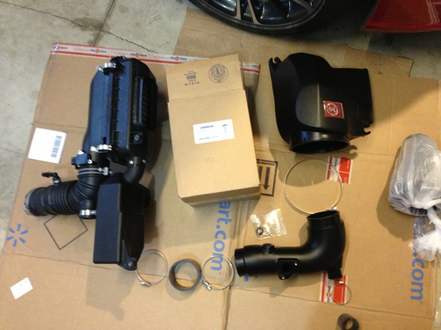

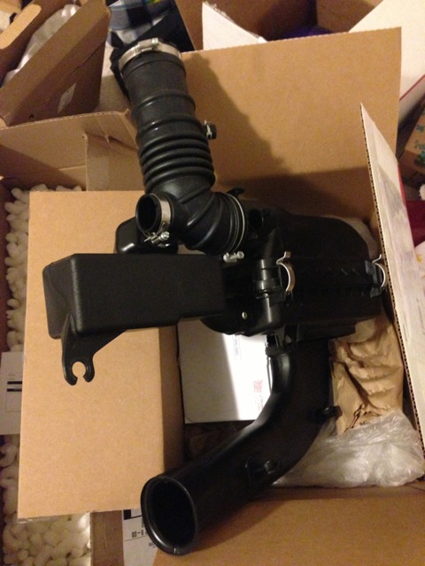

Lverasky 04-11-2013 07:34 PM
3 Attachment(s)
@NoFear99 here are some pic that I took during my install of the aFe Takeda Pro-Dry intake.
Attachment 33596Attachment 33597Attachment 33598
If you look at the second pic, that air scoop is on the way if you try put in the intake. That air scoop have to be romove.

Lverasky 04-11-2013 07:53 PM
Here's the pic of my stock intake with air scoop that removed from the car. Many thanks to help from @Chen to get that install.Attachment 33599
