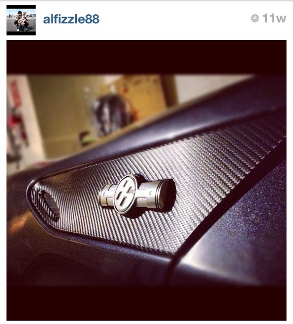

Fizzle 01-04-2013 09:43 PM
Attachment 24453
