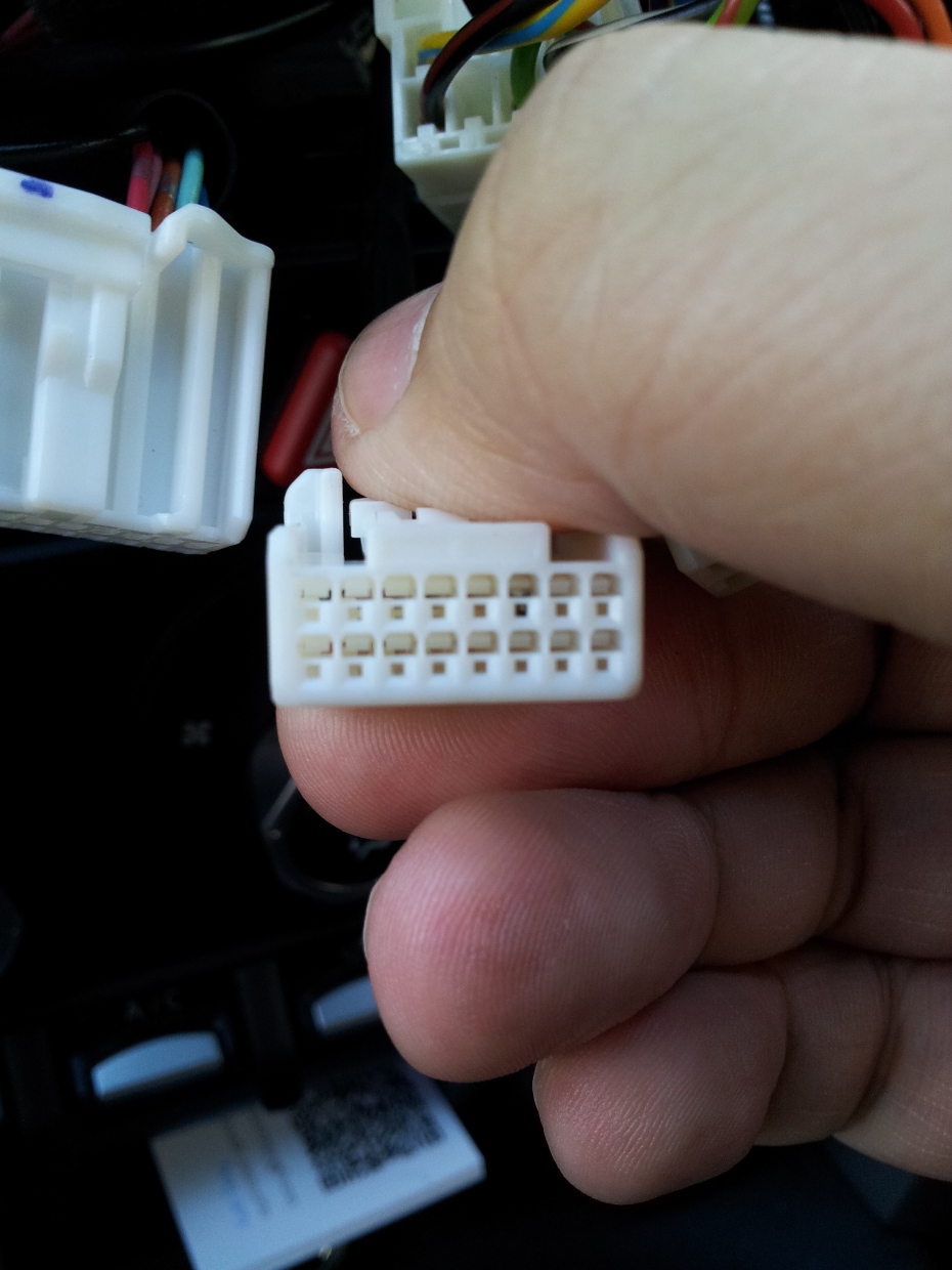

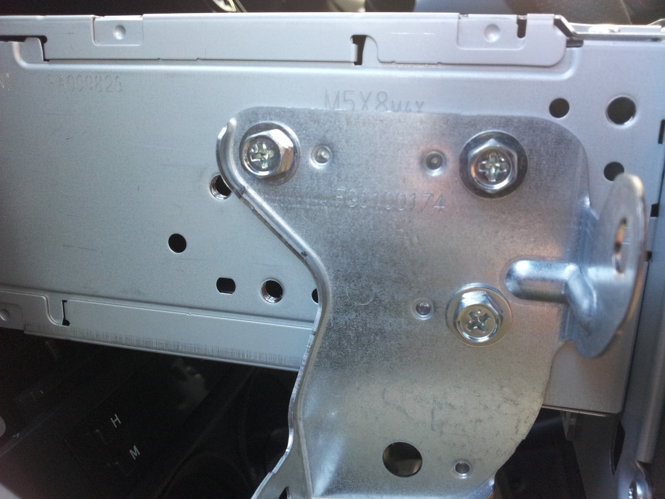

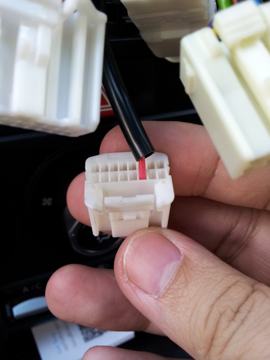

Hi SVXdc,
Like most other countries, us UK folks don't have reverse cameras as an option at all and there are quite a few of us on a more local forum who'd like to fit one but have no idea how to connect a camera to our OEM head units. So this maybe a long shot but I was hoping you could help us UK folks with figuring out which pins are used for a reversing camera on our head units and if possible, even source adaptors/harness' for after market cameras, if you willing to post all the way to the UK that is.
We know that our head units are capable of being used with reverse cameras as there are other Toyota models that do come with the same head unit and have reverse cameras available as extras. I've tried asking some local dealers here about how they connect reversing cameras to other vehicles with the same head unit but they don't seem to be willing to help or just have no idea.
How exactly does one find out which pins are used for what?
I've attached some pics in the hopes that this will help as well as these links to the installation manuals for the head unit:
Standard Touch Head Unit:
http://www.toyota-tech.eu/aimuploads..._002_549_0.pdf
Nav Touch & Go Head Unit (same head unit but with different software and added underside module I believe):
http://www.toyota-tech.eu/aimuploads..._002_551_0.pdf
This is a pure guess but could it also be the 16 pins for us as well? Could the one red cable be from the reversing gear? And since most after market cameras require 12V, do you still have to hook up the camera to the reverse light for power or should most head units supply enough voltage?
Any help would be much appreciated and if you could create and supply harness' to the UK, I know of quite a few guys who would be very much interested in purchasing them.

Originally Posted by Keethos View Post
Like most other countries, us UK folks don't have reverse cameras as an option at all and there are quite a few of us on a more local forum who'd like to fit one but have no idea how to connect a camera to our OEM head units. So this maybe a long shot but I was hoping you could help us UK folks ...
Thanks for the great pictures! Please see my reply in this new thread: GT86 TAS300 rear camera input
