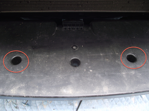

* Oil cooler mount - Perrin has some nice mounts provided for you, but there is no real need for one. I used two 65mm bolts/hex nut with 4 fender washers to secure the oil cooler. Why 4 washers? I used 2 on each side - 1 for the underside of the car, and another to place under the oil cooler. Basically covering the plastic rivet hole from top and bottom.

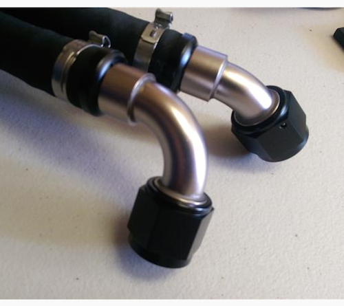

* Lines and fittings - You'll need total of 8-foot long ss braided lines, two 90-degree AN fittings and two 45-degree AN fittings. I made a mistake and got two regular fittings instead of 45-degree ones.
As you can see, the straight fittings made it impossible to gain access to the oil fill cap. It's pressed against the air box. I think you should be able to get away with normal fittings if you have CAI or a different air box. I was able to find one 45 degree fitting locally and made it work.
