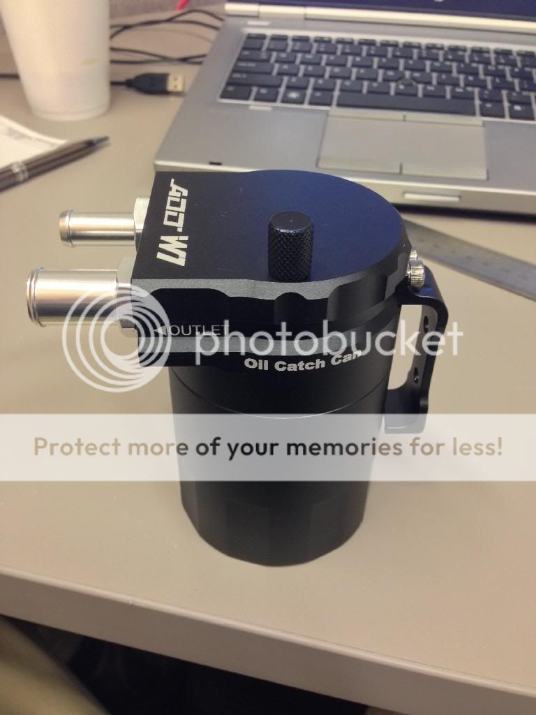

ADD W1 from eBay. I think it was $80 shipped. Us seller. Built VERY well. I would say it is VERY comparable to the radium catch can. One issue. They don't provide sealing washers for the nipples. They do give you 2-9mm and 2-15mm so it is perfect for our application. Buy a couple sealing washers from McMaster and you are golden. I opted to put the provided O ring on the OD of the canister threads because I believe it will seal better. I also put a small O ring on the dip stick.
[IMG][IMG]http://i332.photobucket.com/albums/m340/sickcis/BR-Zed/61672266-B795-4876-A59B-437***C60FD7_1.jpg[/IMG][/IMG]
I added a little extra baffling as well. I think radium uses a screen but this will do the same thing. Don't add too much because you don't want to restrict flow. Just something extra for the oil to stick to.
