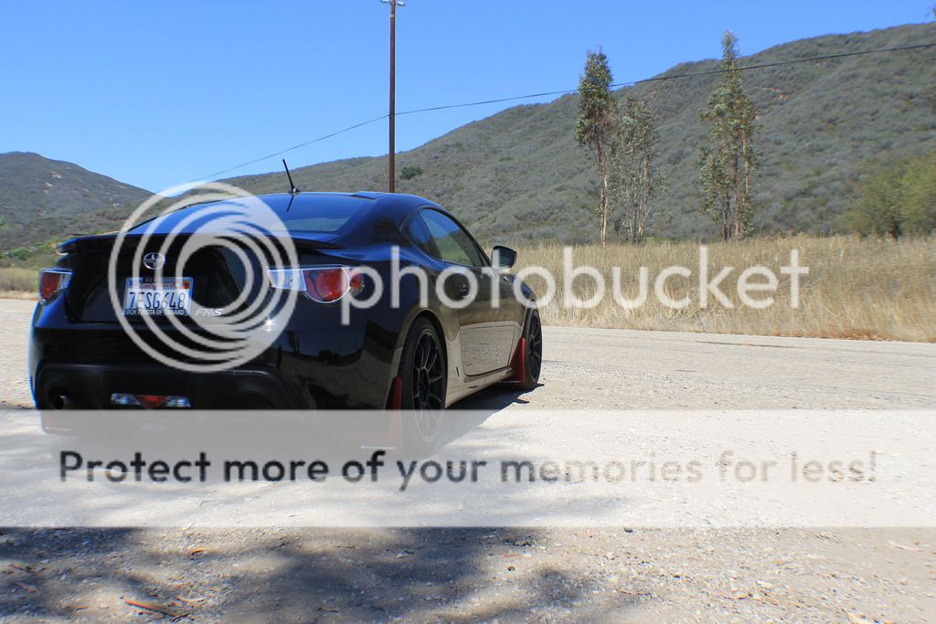

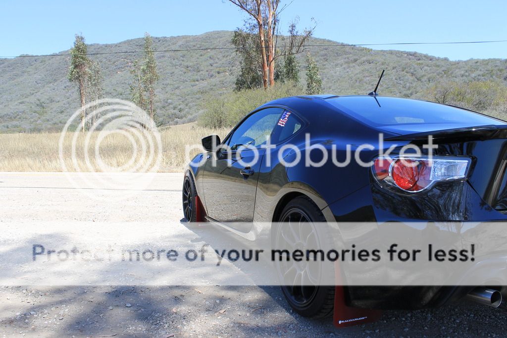

Leonardo, here's a couple pics i found in my phone (was late for work didn't have time to take new ones )
