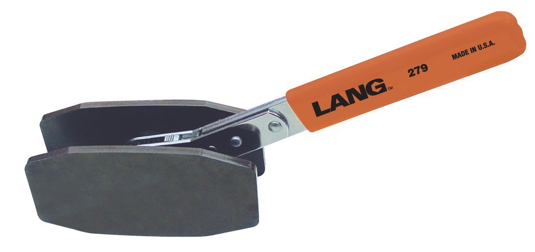

Speaking of which, does anyone have a favorite brake spreader tool for calipers like this? This Lang tool looks appealing. Has anyone ever used it?
Amazon link here

The Lang tool doesn’t spread out far enough to compress the pistons on the AP Racing calipers. Might purchase the Leslie tool if it can spread further.

You can use the Lang tool to compress the pistons if you push against the worn out brake pads inside the caliper.

When I used the Lang tool and just grabbed the backing plates. You can also take one pad out and fit it in there.

My AP pistons have always been difficult (but not impossible) to compress by hand, since brand new. Now I just use the Lang tool with worn-out pads.

I use one of these with an old backing plate to compress pistons:
