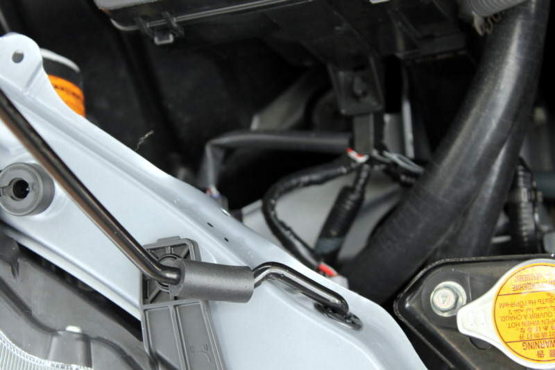

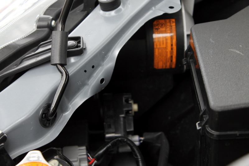

Installed a Mishimoto catch can today. I got the compact version so there would be plenty of clearance around it to work. Mounted it behind the passenger side head light. That spot gave lots of room to work with clearance to remove the can for maintenance and cleaning. There is a tab of sheet metal right where the hood prop connects. I bent it down gently and drilled the 2 small holes to mount the can.
I reused one of the EVAP hoses I removed during the supercharger installation. It was the perfect length and even was bent the right way. Hooked this hose from the PCV valve to the inlet of the catch can. Then I used the leftover Cosworth hose I had from my installation. This is the long unmarked hose that was called "10" earlier in the thread. There was more than enough to reach from the catch can output to the back of the throttle body. I routed both hoses underneath the intake manifold. So far it works perfectly. Drove it a little today and the bottom of the can was already damp from catching blowby.
All I paid for this project was a catch can which I got for $77.50 new on eBay and a roll of polyethylene tubing from Lowes. The tubing was to make a bushing to go from 3/8in barb to 1/2in for the larger Cosworth hose. All the hoses I used were left over from the supercharger install which makes it look more OEM.

Indeed, looks very oem. Nice and clean job. It would be nice, if you sent some pictures where exactly you plugged the hoses. I wonder how much oil it will collect.

I wrote down my mileage. I'll check it in a few hundred miles and show any oil accumulation it may have. I'll get some pictures later of the connections, but basically you need to remove the PCV hose and then route the PCV valve to the "IN" on the can and then connect the "OUT" of the can to the throttle body.
Remove the intake tube to make it easier. Attached to the intake tube is the hose that goes to your crankcase breather. This hose attaches to the intake tube on one end and to a port under the AC over on the driver's side on the other end. Disconnect the end that connects to the intake tube. This will enable you to remove the tube completely and set it aside. You will not be attaching the catch can to this hose.
Then on the passenger's side (US car/ LHD), look back at the throttle body. There is a single vacuum port with a hose that goes from that port, down to the top of the engine block. That is your PCV hose. Remove this. You will see a shiny port on top of your engine where this hose was connected, located under your intake manifold on the passenger's side. You can see it if you stand back near the battery. That is your PCV valve. You need to connect a hose to the PCV valve and then route it to the "IN" on your catch can. Then connect another hose from vacuum port on the passenger's side of your throttle body to the "OUT" on the catch can.
That's it. Be sure to use hose clamps so you don't get a vacuum leak. Then reattach the breather hose to the intake tube, put the intake tube back on and you're done.
