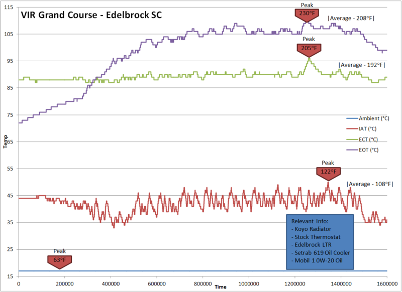

Originally Posted by NotSoJDM View Post
This Saturday, VIR Grand Course
Videos & Datalogs to follow.
Please try to log Intake Air Temps before and past the intercooler.
ATL BRZ is offline   Reply With Quote
Old 11-23-2015, 11:20 AM   #367
NotSoJDM
NotSoJDM's Avatar
Drives: '13 BRZ | '04 E55
Location: Wake Forest, NC
Posts: 916
Thanks: 401
Thanked 717 Times in 284 Posts
With the Edelbrock kit their MAP harness relocates IAT signal to the MAP sensor post heat exchanger, IIRC. Any suggestions on how to log IAT from original MAF sensor with this configuration for pre heat exchanger temps?
NotSoJDM is offline   Reply With Quote
Old 11-23-2015, 02:58 PM   #368
Kodename47
Kodename47's Avatar
Drives: UK GT86
Location: UK
Posts: 3,040
Thanks: 185
Thanked 1,626 Times in 1,112 Posts
Mentioned: 155 Post(s)
You'd have to make a custom harness and use the rear O2 port and custom map it. TBH it's relatively worthless as you can just log ambient temp which will give you a decent enough idea of the pre and post cooler temps.

I've attached a temp graph I put together from one of my afternoon sessions at VIR. Still working through some of the other data. ECUtek did this wonky thing where it split one of my 25min logs into about 40 different files, so I have lots to look through. Ignore the units for the Time axis.
Never known ECUtek to do that. There's a merge tool in the file menu where you can drag and drop multiple logs to join them up, or in your case restore them
Looks good, thanks for the log! You've got some important cooling upgrades. I wonder if there might be heat concerns with a stock setup on say an 80o average ambient temperature day and/or on a 'gearing challenged' track. ie, in a 6-spd stock setup on NJMP Thunderbolt or Thompson, the car spends a LOT of time in the 6.5-7.2k range because it's just not practical to grab the next gear before braking.
Have you thought about trying a 30wt or 40wt for track days?
No, I haven't really considered trying a different oil for track days. I have used Mobil 0W-20 since I bought the car new, and had an oil analysis done at 62k to check up on things. Everything looked good, so I have kept with it without much thought going towards changing it up.
