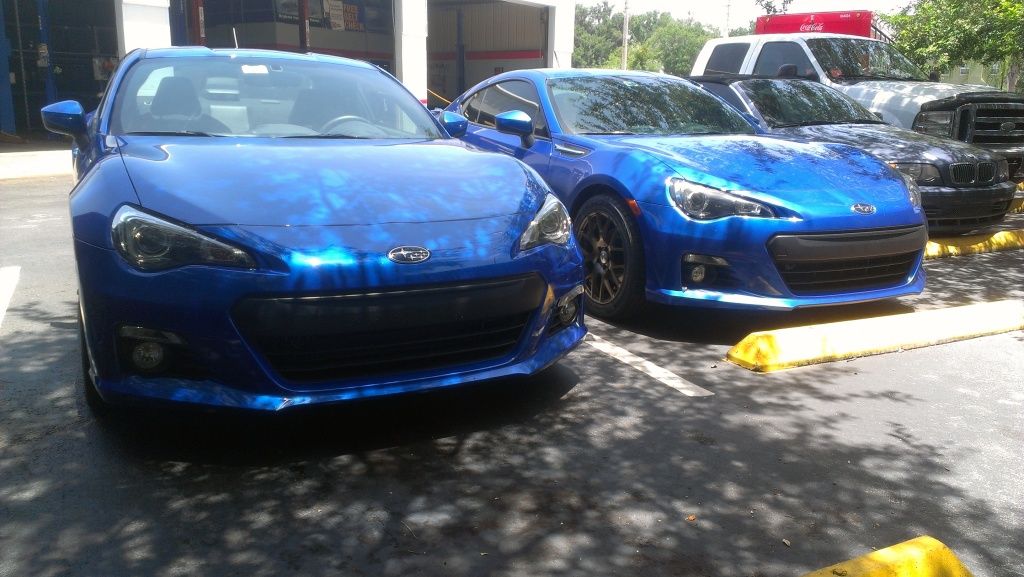

It was good seeing you out at the Suby meet last night! Car is looking good. here is the link to the meet thread i posted on here FYI. http://www.ft86club.com/forums/showthread.php?t=10798

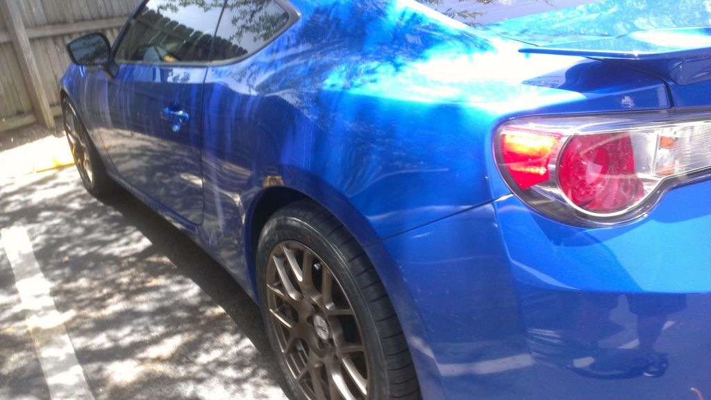

17x8 +35 TSW Nurburgrings in Bronze, wrapped with Kumho Ecsta LE Sport in 235/45R17 Y:
After getting the tires in from Tirerack 2 days after placing my order, I had to wait another week for the wheels to come in. Once they did, I kept missing the UPS guy (inaccurate time windows of when he'd be arriving at the house didn't help), until I finally called up UPS and had them contact the driver, who I was able to meet at the mall closest to my job while he was doing his mall deliveries.
After finally loading up my car with the wheels, I noticed it was late enough in the day where I had no time to drive home to drop them off before my work's summer bowling league started (and I wasn't about to miss it, since it was the last week, when everyone gets multiple pizzas and hot wings to end the season). It felt weird leaving the wheels in the car, but luckily the car's tint combined with the time of day made it pretty much impossible to notice unless you were pressing your face against the windows. Once home, I snapped a few pictures of what I was itching to have mounted:
The yesterday, I was able to get a coworker give me a hand getting everything over to the local tire shop for everything to be installed. I had them reuse my stock wheels' TPMS sensors, which they were able to remove without actually removing the stock tires from the stock wheels, which made it much easier to bring everything back home afterward.
Side view:
Width of the 235s from rear:
Width of the 235s on the front:
+35 offset on 17x8 from rear:
+35 offset on 17x8 from front:
For those who haven't tried fitting wheels+tires, it's quite easy:
View of packed wheels+tires from front seats:
View of everything about an hour later.. Really wish the camera could properly show how bright the bronze gets in the sun:
For those curious about the weights of these, they're rotary forged, and weigh in at 17.95lbs per wheel in the 17x8 size (compared to stock wheels at 20.1lbs). Tires are 23.4lbs each (compared to stock's 20.39lbs), for a total weight increase of 0.86lbs (this number pops up everywhere ) per corner for wider, better-gripping tires. It also appears that my speedometer is now more accurate than before, thanks to the larger tire diameter

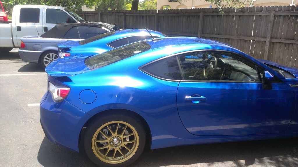

Alright, finally had a moment of free time (kind of..) to post a few pictures of yesterday's hard work, along with a little bonus from today..
As mentioned in my previous couple of posts, I was able to finally figure out what the hell I was doing with the suspension by the end of last night, and took a few pictures of the car post-drop. I basically followed Grimmspeed's Safely jacking and supporting and DarrenDriven's Lowering springs installation DIY guides for the actual installation of the springs, and installed the Whiteline parts while putting everything back together in the front.
During today's alignment, I was told the back is too cambered, and I need to install a camber kit. I did purchase Whiteline's Rear control arm upper inner bushings, but after the install dragged on as long as it did, and I didn't have overly detailed instructions on how to actually remove the rear control arms to get this part done, I decided to put it off until after my vacation (beginning tomorrow ).
As for some pics:
This is actually the WRB demo BRZ I snapped photos of back in March (I didn't take any pictures of my own engine bay in its virginal state)
My engine bay, post-lowering springs and Com-C strut tops (notice the silver color of the strut tops and the cap located further in to the center, for close to a degree of both negative camber and extra caster)
The car dropped:
Front wheel:
Rear wheel:
