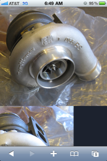

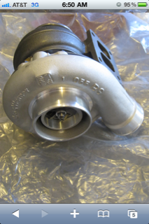

Bought a new turbo which will be here sometime within this week, I asked the seller to send me pics of it, this is a brand new never used BorgWarner S366 with ETT, it has a .91 AR and is a 67mm and a twinscroll, i also purchased a turbonetics cast manifold to use until SP's F1 Tubular manifold is off backorder of several months, I will be incorporating a QSV(Quick Spool Valve) on this new turbo along with a 4" DP with a 4" 11psi boost activated cut-out. Enjoy the pics, I'll post up the install once I acquire a 44mm WG and the 4"DP
Sorry for the crappy iPhone pics, I'll take some good ones when it arrives

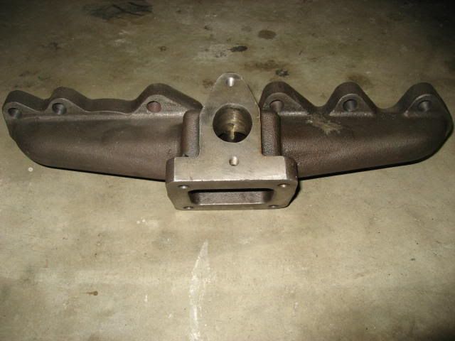

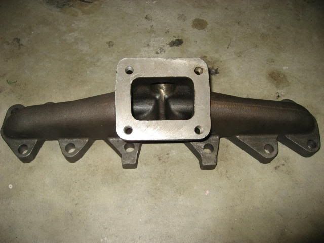

Here's the turbonetics cast mani(100$ cheap hold me over)

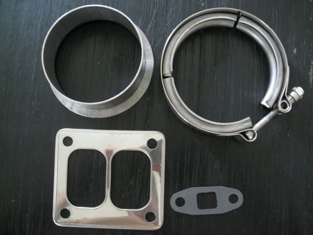

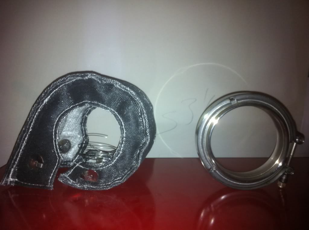

The 4" V-Band assy and BoostLogic T4 Turbo blanket
Here's the 3" v-band assy. And turbo/manifold gasket
