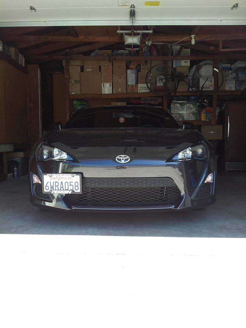

I finally manned up and did this and I must say, I'm glad I did it, thanks to Darrin for this diy, I nearly wanted to give up when I was opening my headlights. Most nerve racking experience! Will have some pics soon.
If anyone is having a hard time with taking out the side markers heres a video I used and it was actually super easy to take off without breaking it.
[ame="http://www.youtube.com/watch?v=xP6tbrGyN1o"]2013 Scion FRS Subaru BRZ Horn Upgrade DIY - YouTube[/ame]
Picture time!!
Definitely glad that I did this
