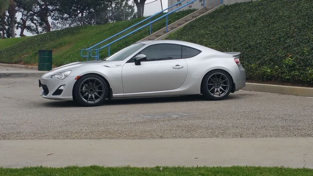

I had my RSR super downs for 5 months now and I would never go back to stock height. Nice functional drop for my daily driver and is only bumpy on crap roads. Although it is still only a tad rougher than stock springs. I've gotten used to the height after a week and have not scraped even on pretty steep driveways when taken at an angle.
Here's a pic of my car with 18x8.75 +35 XXRs.
Looks really good!
One thing I was unsure of is if I'll still be able to fit my jack under the car, might have to look into that lol. Just got the low pro jack from harbor freight.
