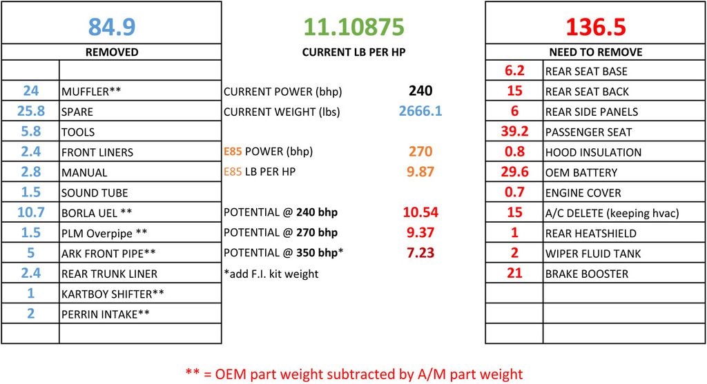

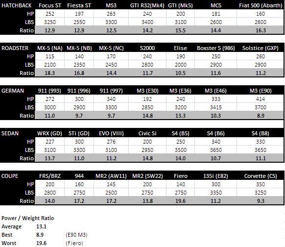

Did some homework for myself... now I'm highly motivated.
First image is not mine, second is the homework:

Oh, awesome! No, I didn't know about the brake booster eliminator. I haven't had much time to keep up with new 86 products in the last 6 months or so, and I'm realizing there's a lot I don't know about right now.
And good job on that chart.
