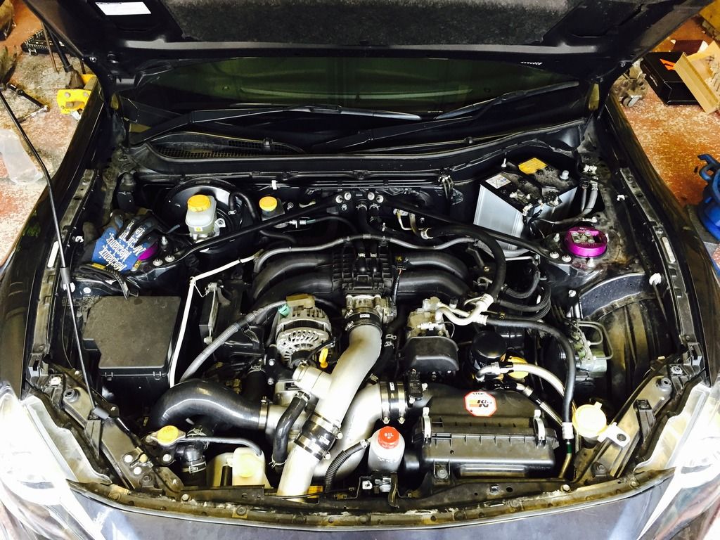

The HKS v2 is now fitted
I had ordered a mishimoto oil cooler kit to fit at the same time as doing the SC install knowing full well that I would probably need to mount aspects of the SC and Oil Cooler kit differently.
I've mounted the oil cooler alongside the intercooler, cut the oil lines to shorter lengths to allow me to get it fitted here. I've mounted the traction fluid cooler behind the 'cold side' of the intercooler.
Installed a delicious tunings flash and go tune and the car is running well
