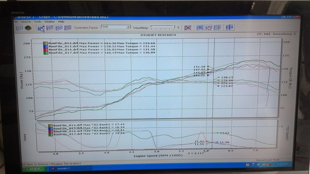

Little update from today. Went and did all new data. #'s were all off so we had to do new baselines to test another version of the cold air which doesn't work.
Heres a Picture for now.

Pay no attention to the crazy peaks in the graph. Thats just our wideband connection giving us trouble again.
Its 99 Degrees in the shop today and about 2000% humidity. I can't stand to be here any longer.
Run 14 Short Ram Intake - Power looked to be down. So we decided to baseline again. Figure the terrible weather here was the culprit.
Run#15 and 16 are back to stock setup but without the air horn in the front of the bumper.
Run #17 I had been testing the long cold air all weekend long and it felt great. Well it made great power but it is just far to lean for comfort. Scratch that version as well.

Still the original version has given the best results hands down. The short ram is still the best viable option so far.
