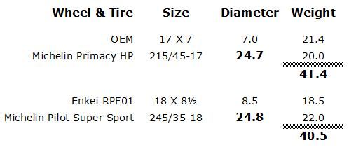

Originally Posted by dradernh View Post
Tire Rack can get you close (see below), and it's a lot better than decent.
Note that the diameter of 245/45-18 tires is two inches greater than stock.
I wouldn't use tires that larger in diameter than stock. It will reduce performance. Probably 1/2 of an inch bigger is OK, but no more. And you should try to keep total weight of wheel and tire the same or lower than stock. $2000 for a set is duable, but likely if you agree to stay with 17" size.
dradernh is offline   Reply With Quote
