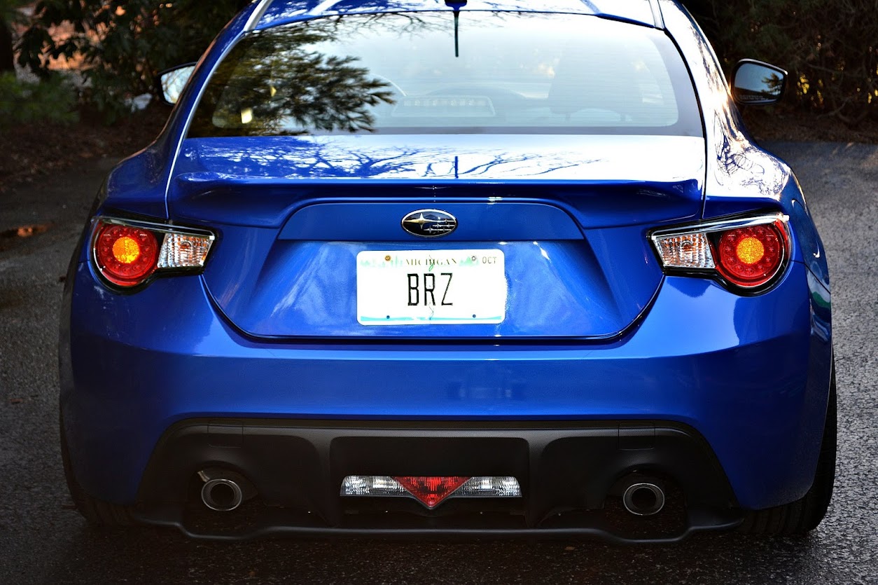

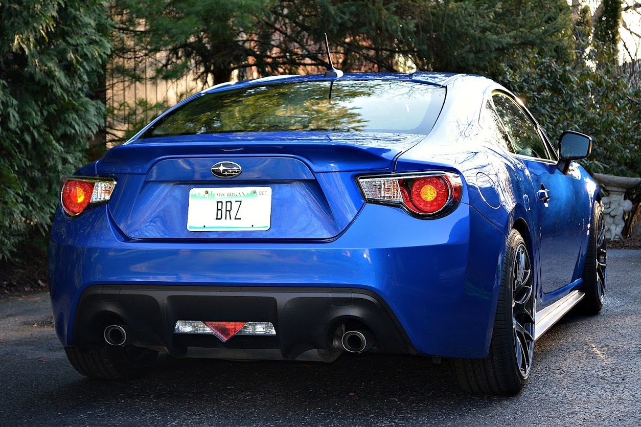

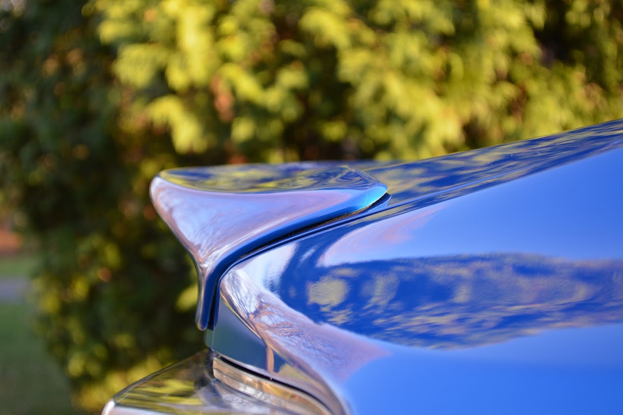

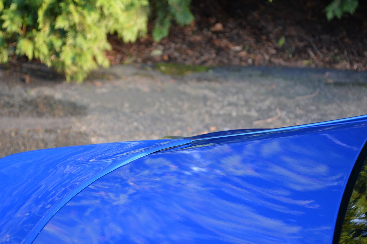

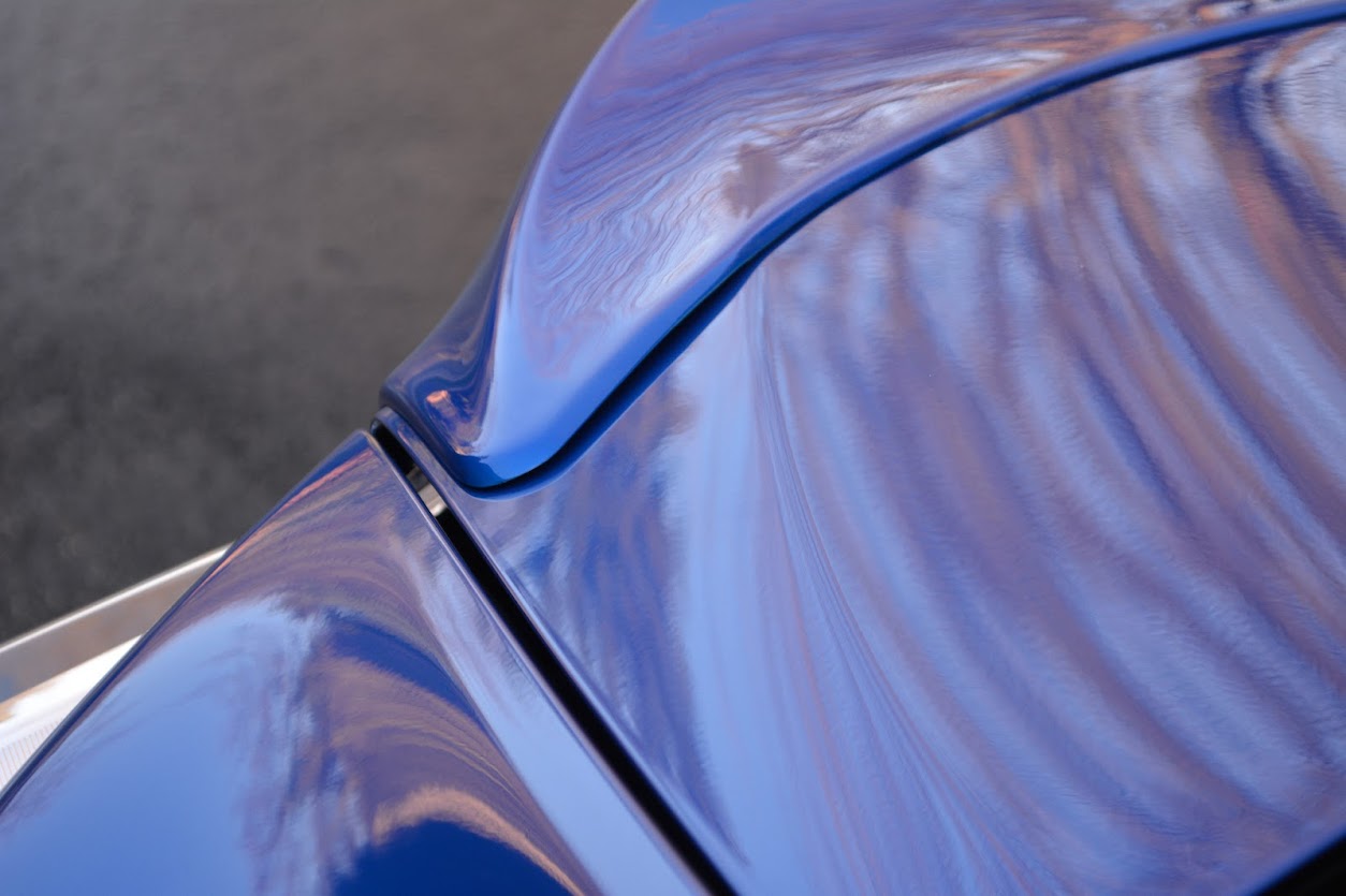

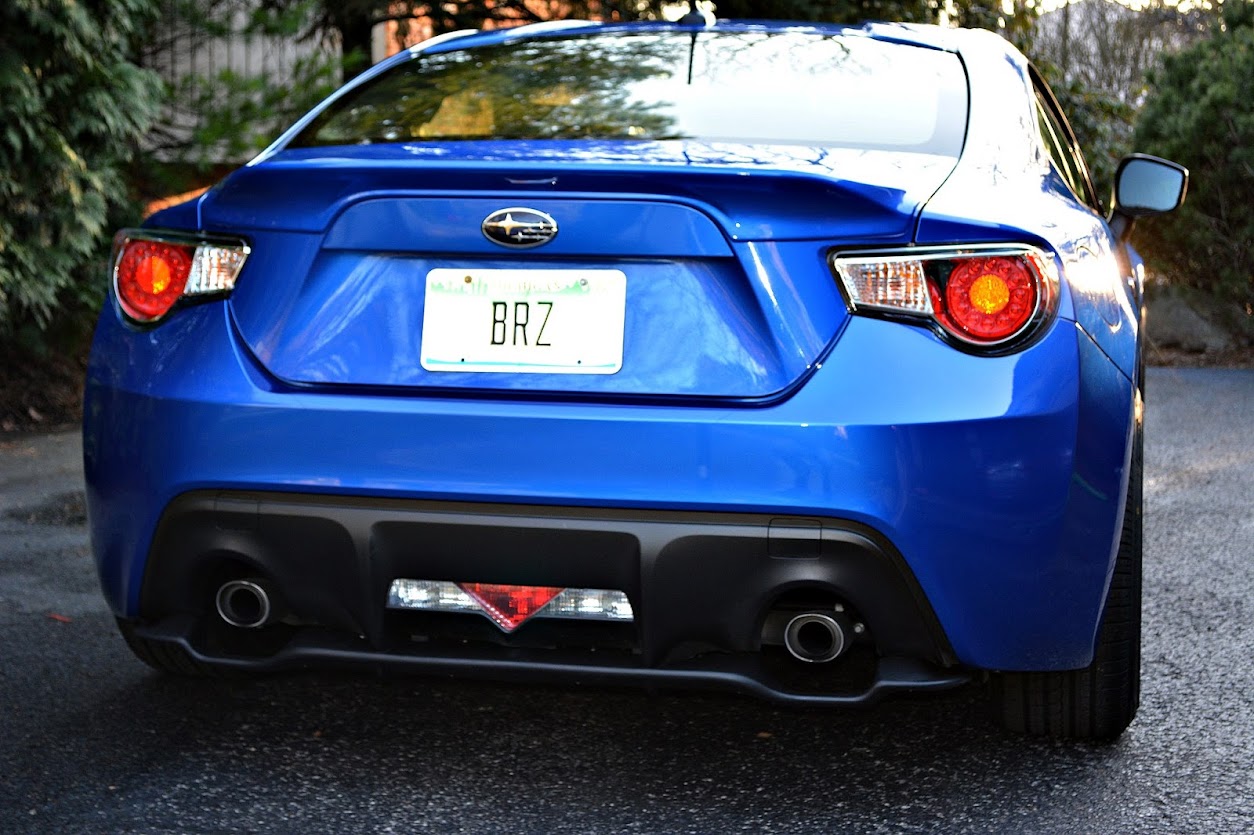

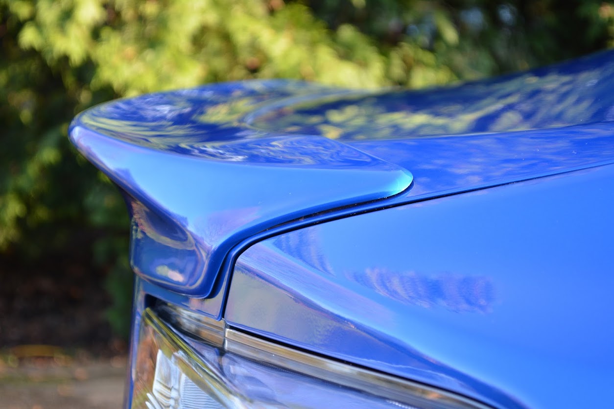

My review of the STIVO spoiler..
not impressed. Granted it was cheap at $350 shipped and painted.. but still.. not the best piece and even at that price, I'm not sure I got what I paid for.
I love the design.. The shape of the part and the lines are fantastic. It really looks good on the car (from a distance).
I don't love the paint match and I hate the fitment.
Notice the fitment issues.. it's like they didn't get the trunk curve quite right on the outside edges. There is a gap at both the front and back side.
In this photo you can see the paint is odd.. it's the same base blue, but it seems like a different clear finish or something.. just a bit off color. Also, notice the bad fit on the top right.
The shot isn't so clear here, but you can see the paint color issue: It's close, but you can definitely tell it's not factory.
eikond is offline   Reply With Quote
