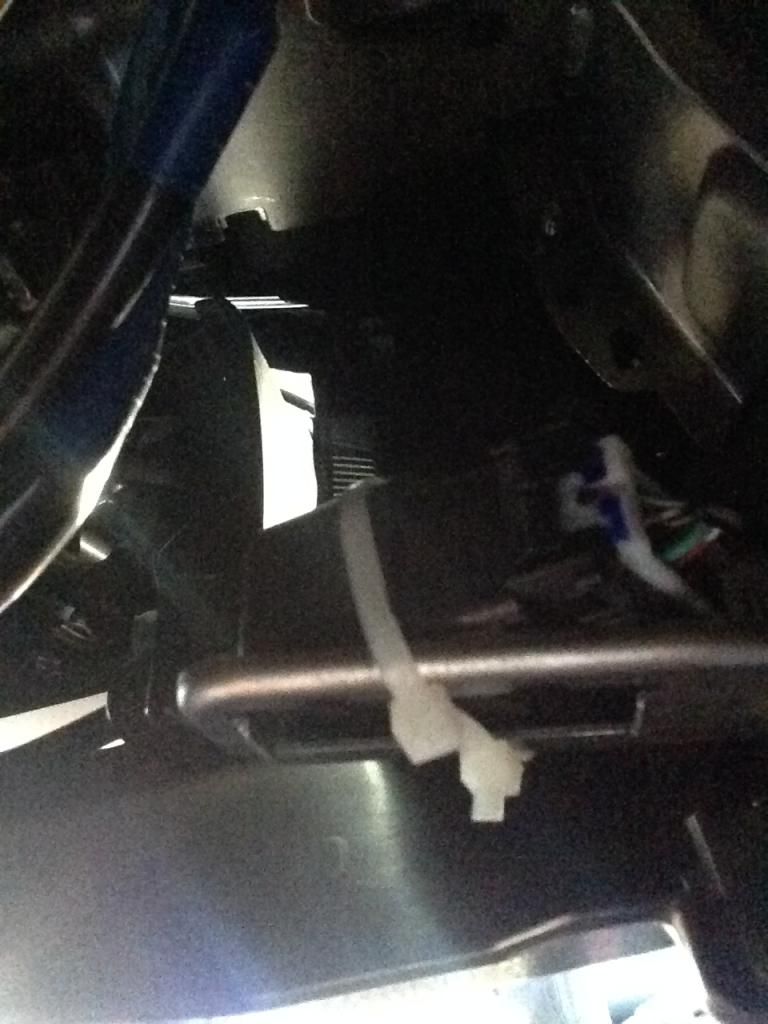

i unmounted my obdII port under my dash from that flimsy metal tab, plugged my OFT cable into and ziptied both in place under the dash, now my cable isnt angled down towards my feet and bent up around. now it goes strait up and comes out by the top of my steering column and up to my dash where my oft is mounted. i used to have this problem as well, and now i havnt had it since ive done that 6 months ago. lots of track days and bumps with this set up.

yep, thats alot of stress on the connector, which is why i unmounted the OBDII from the metal tab so theres no stress on the connection point.
