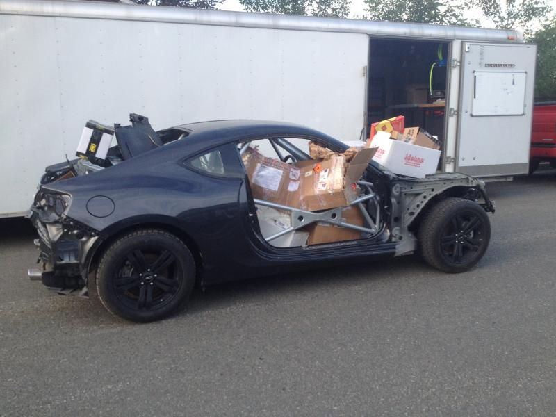

Now here is the part of interest, the build. We bought a car that was salvaged due to what we think is hitting a small tree that fell on the car afterwards. The car needed a front bumper, hood, right fender, mirror, air bags, dash, new seat belts, windshield, radiator, AC condenser, it had some knicks on the doors, A pillar, cracked rear bumper , etc. Basically, we were able to source the parts we needed for like 1500$, air bags and all we obviously didn’t need. We forgot to take some pictures of the car before we started tearing it down, yeah I know, not good. Anyway, the first thing we decided to do was to strip it and send it to get a FIA roll cage made. We decided not to attempt at making it ourselves because we didn’t have much time and wanted to start testing it this year.
Here are the pictures of the roll cage

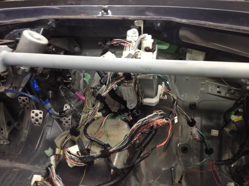

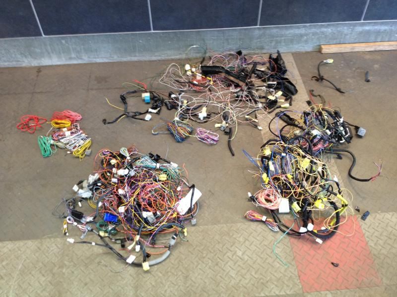

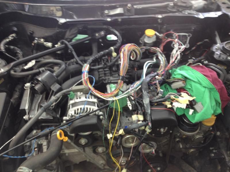

Then I started attacking the wiring because when I tried to install the body ECU and the Power Steering ECU back in place, they wouldn’t fit because the roll cage was right in the middle of it. I had to relocate both boxes. I didn’t take many picture of it either, sorry for not being too reliable on taking pictures of the progress.
Here is where it was relocated
had to modify the engine bay harness too
I really didn’t take enough pictures to show the mayhem it made but here is all the wiring I took out, all 14lbs of it. I hope there was nothing I needed in there

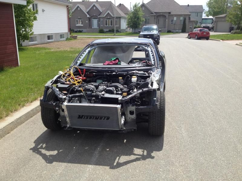

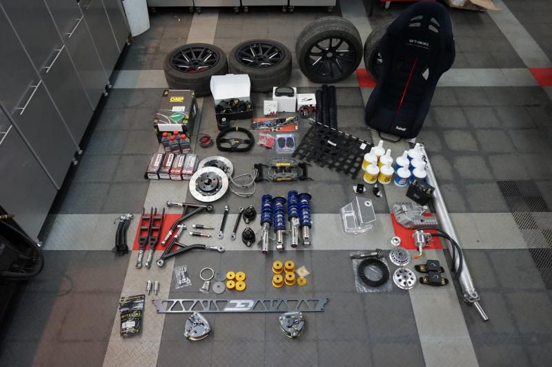

Finally, we have a radiator, the car is ALIVE! What a relief after all that wiring, I must admit I was kind of nervous after that hack job.
We have finally put all the parts we bought ON the car

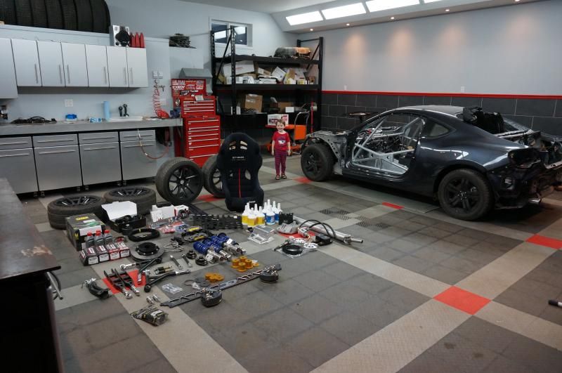

Ok seriously, we decided to lay all the parts and make a nice picture just to remind us how much money was going into this project.

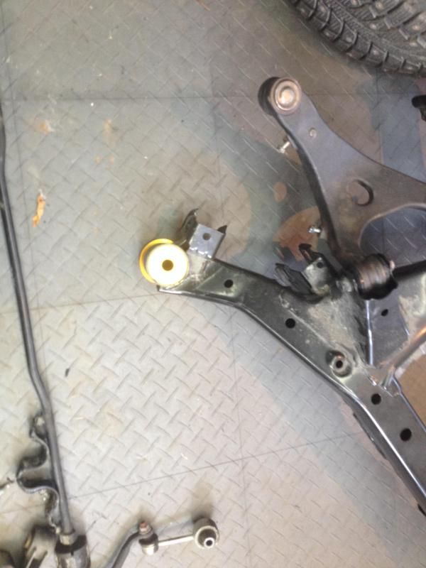

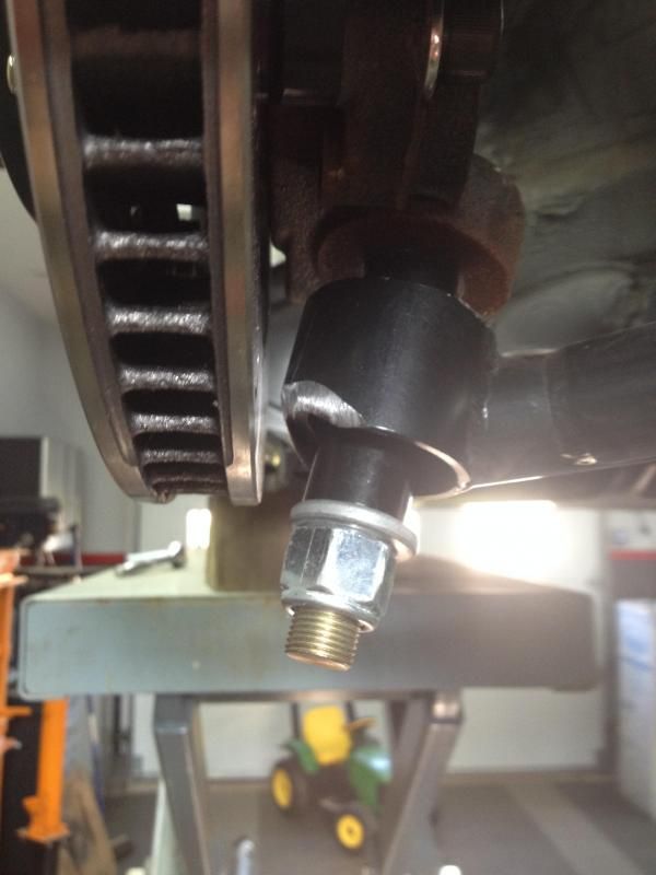

Picture of the front suspension before
and after
Had to modify the RacerX lower control arm because they didn’t fit with the BBK
Charcoal canister and all emission stuff gone

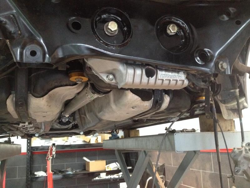

Solid subframe and diff bushings, what PITA job it is
Here is yesterday’s project, Exedy stage one clutch and flywheel
I think we can see the Perrin engine mount a little bit too.
And here is where we are at now, diff with 4,56 and Greddy cover installed, solid bushings everywhere, Whiteline transmission mount and aluminum driveshaft
