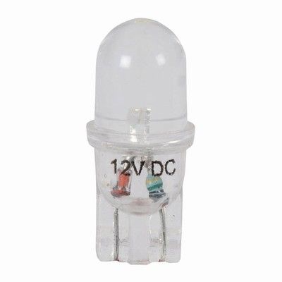

Had this happen to me also.
Swapped out the 5Watt light bulb (437mA) with a low power T10 LED (20mA).
With the LED and dash indicator the current draw is ~80mA, this will allow the light to be on for about 2 weeks with enough power left in the stock battery to start the car.
Awesome where did you order that from?
Got mine from a local electronics store.
The lowest power ones will be ~20mA, you can source from ebay
http://www.ebay.com/itm/Klaxcar-8701...8df2239&_uhb=1
The cre LEDs will be brighter but consume more power ~80mA

Originally Posted by litemup View Post
Wait, I didn't read closely enough. If I get the 20mA bulb I can leave my trunk open for 2 months? Damn it!
You will get about 10 days with that LED, (stock battery down to 30% capacity). Much better than stock bulb (totally dead in 4.5 days)
