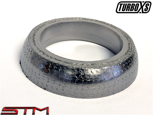

Did you put the donut gasket from the OEM cat on the HFC? It doesn't look like it in the pics.
It looks just like this
and slides/fits over this:
2pt5RS is offline   Reply With Quote

Actually, there is. I put my front pipe in on Wednesday and didn't put that gasket in. I had the same results he did until I realized I didn't put this donut gasket back. Dropped the pipe and put it in and the issue went away.
Unless you're agreeing with me.

its a completely adjustable exhaust (no matter what exhaust you get)...if you loosened every single mounting point and every joint, installed the correct gasket and tightened that particular unit then it should seal. If you did all of that and it still wont seal then yes call Jason and John at Nameless they WILL help you out, but pics of mediocre welds please...
Yes I was saying in his picture there was not a gasket, not that there should not be one.

But yeah looks like you forgot to re-use the donut gasket, was a common issue on the WRX catbacks as well. The Perrin catback does not re-use the donut gasket but it's made not to.
Also make sure that's the first joint you try to tighten and not the last.
