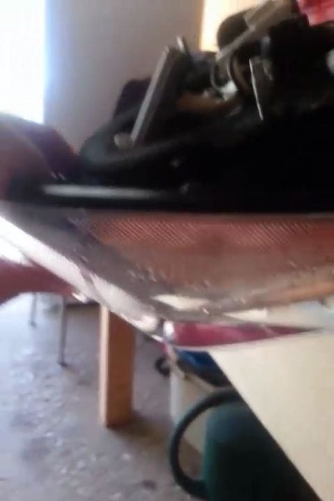

Anyone have condensation this bad?
Here is a video, actual standing water in the lens lol
Drilled 2 small holes and its fine now.
Going to replace these with a set of toms tail lights.

Ill buy those leaking ones with holes in them if you want to get rid of them cheap.
