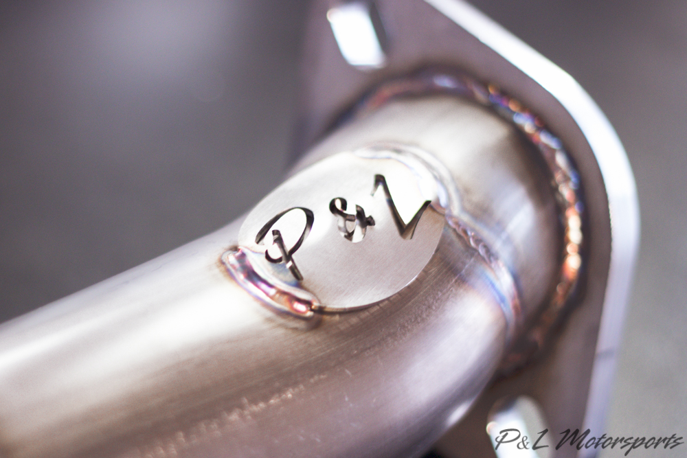

Kind of a cool update on our exhaust components. We're now including a laser cut badge on all of our exhaust pipes! We will also be incorporating this into our intercooler piping and intake pipes in the near future.
