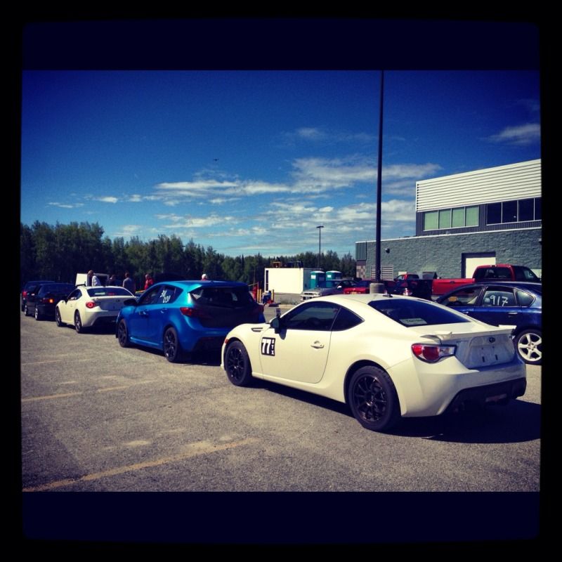

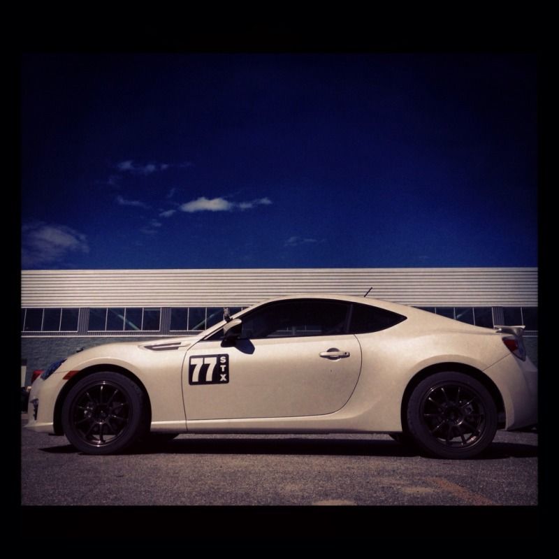

This past Saturday I took my BRZ out for its first autocross. I consider myself a seasoned driver as I have been autocrossing since 1996. I’ve driven mostly Subaru AWD cars in stock or lightly modded ST classings.
The car is set up with 245/40-17 StarSpecs on 17x8 +48 Rota G-Force. I have not checked or messed with alignment yet.
The pavement does not get all that warm here so I started with about 32 PSI and ended up with 30 front and 29 rear.
The car did push some going into turns but was easy to rotate from mid-way through to the end.
I’d like to get a little more front bite without making the rear too twitchy.
I finished 3rd in PAX with 30 or so drivers.
Sorry for the quality on the left side, I found a smudge on the lense.
Here is my best run.
And my best run, although dirty.
Just realized this is a stock class thread, oh well the car is basically stock.
