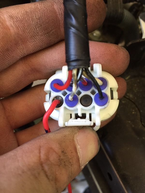

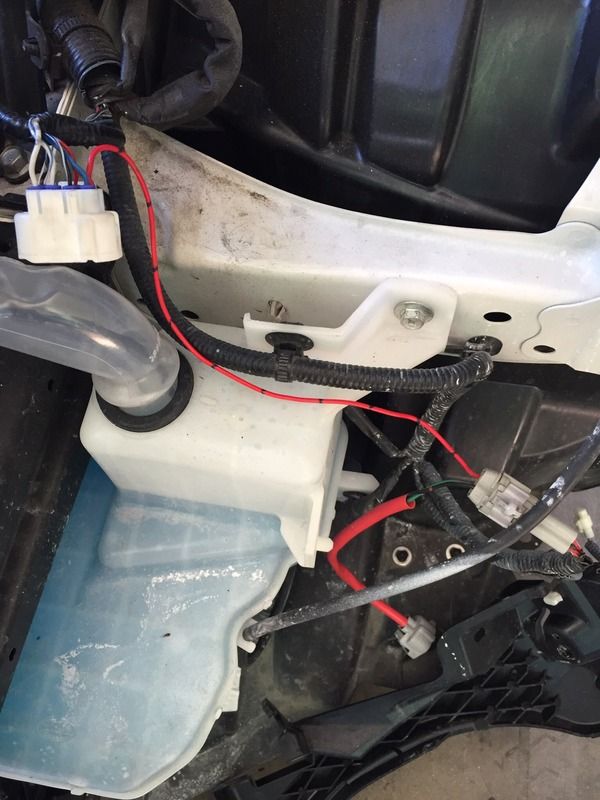

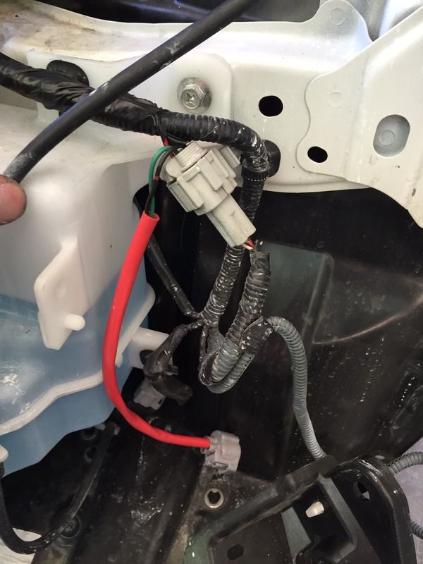

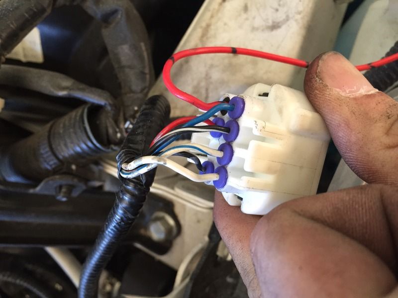

Another option is to buy the 90980-10897 plus which will mate up the stock plug on the brz light. $25 is what I payed but there are cheaper places to get them.
I also moved the indicator light wire to the brz plug by de-pining it and routing it back up to the headlight here is the finished product..
Passenger light plug
Driver side plug

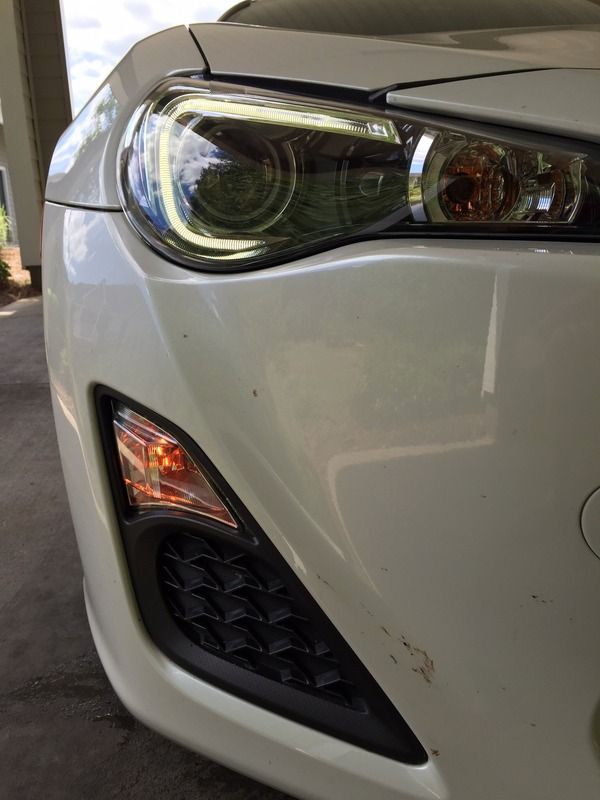

All tapped up
Parking lights on
Headlights on and blinker flashing
