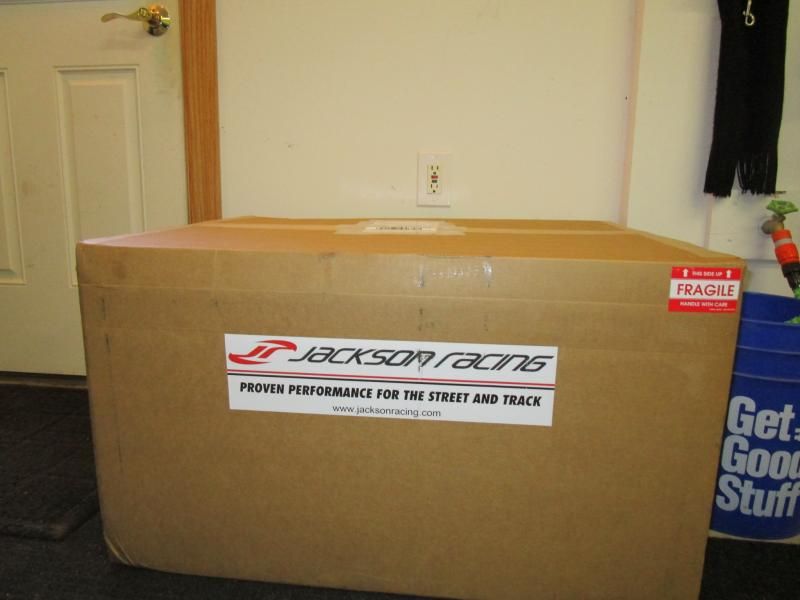

I'd love to come by for a ride, but I am a long ways away in MN.
I guess I am really driving in the upper RPM's if I want power anyways. I had this thought that the UEL may help out with the parasitic loss from the extra load from the supercharger at lower rpm's. I will have to rethink this.
How much power do you think the equal length adds to the JRSC if all else is otherwise stock?
By the way, my package from you came today!
