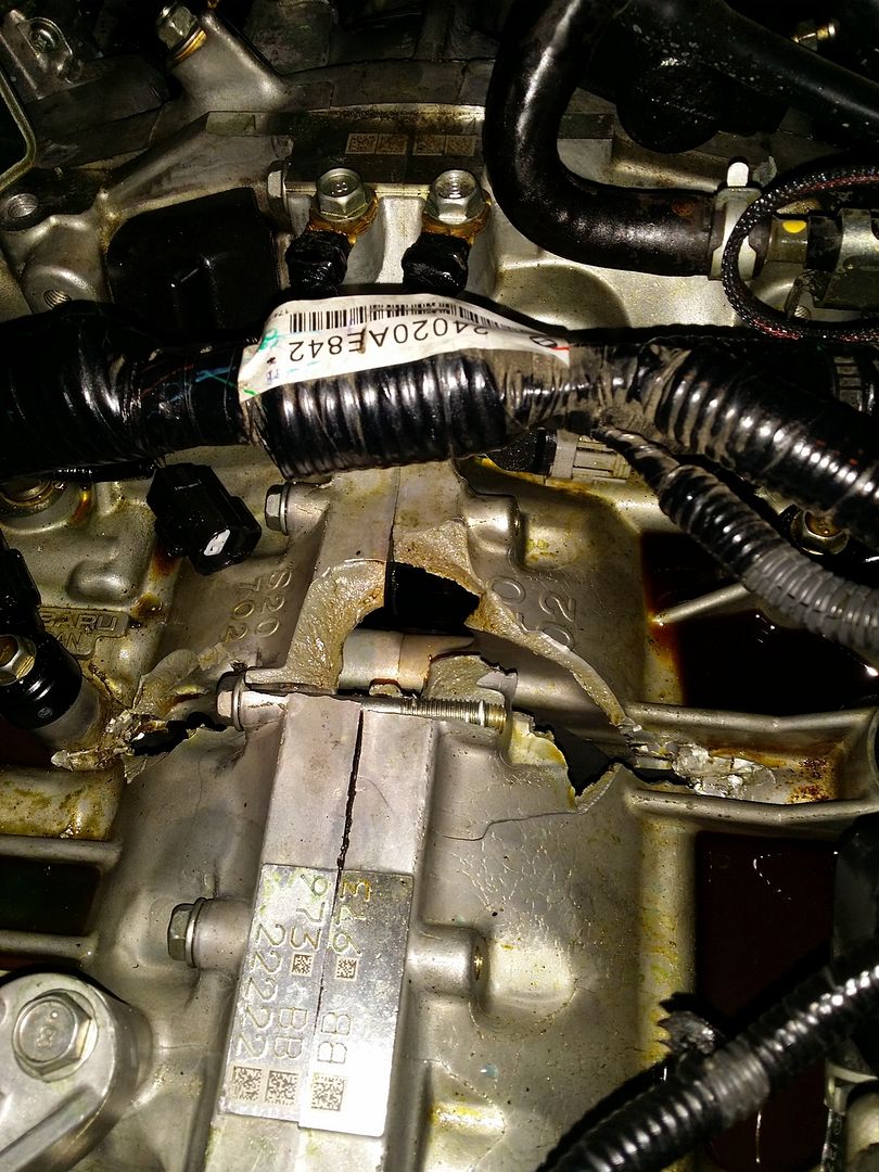

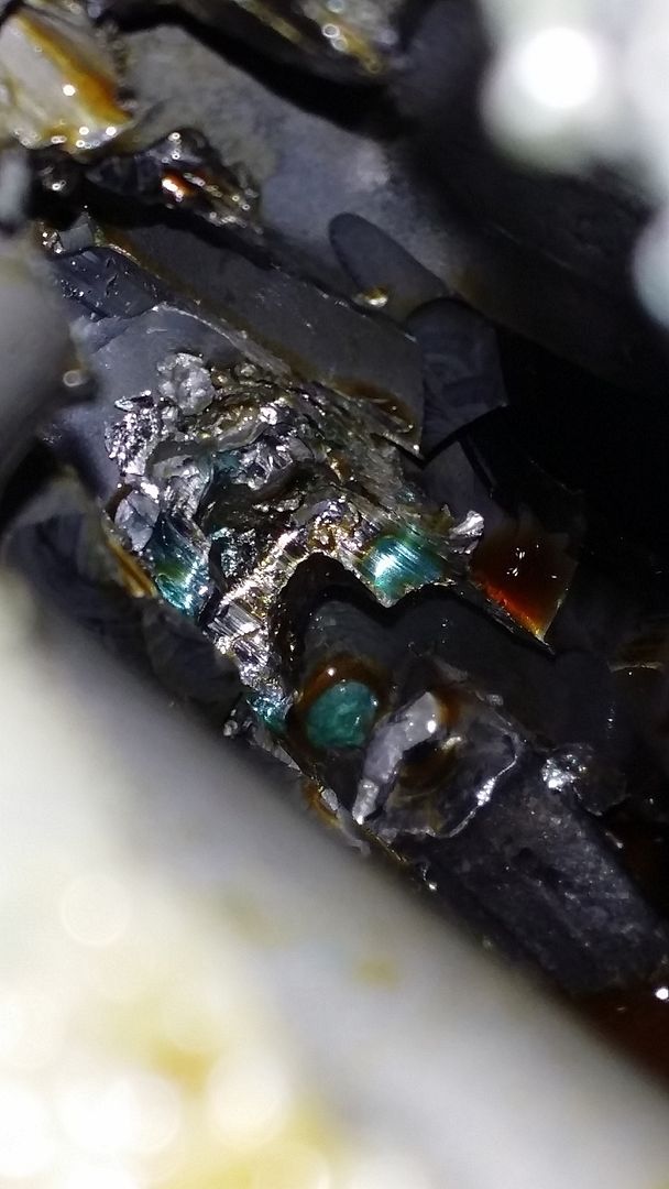

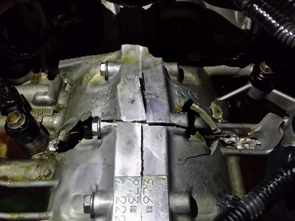

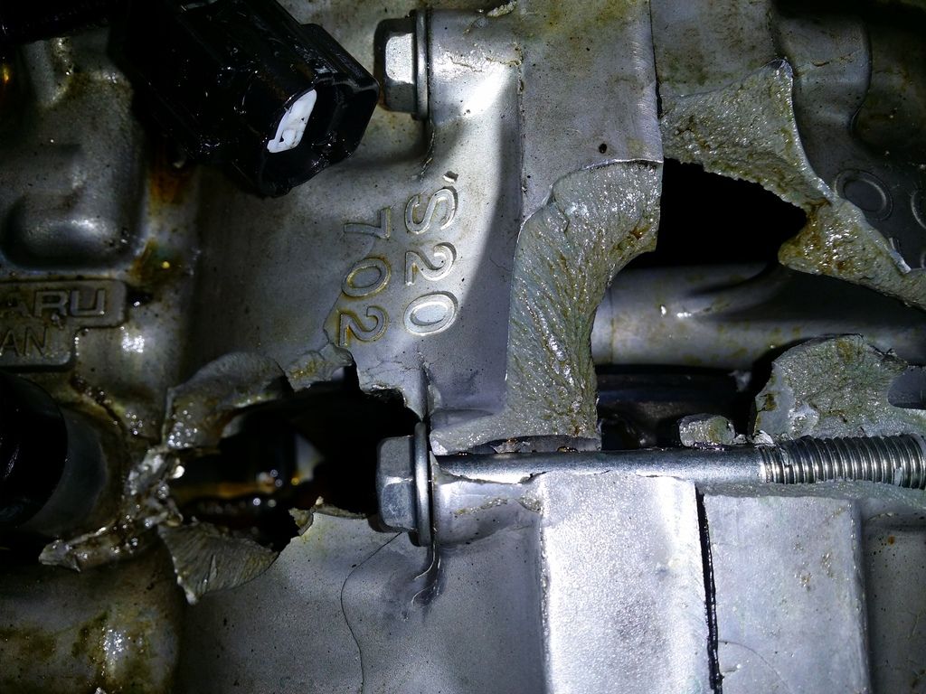

Old 05-11-2015, 12:13 PM   #363
FrX
Drives: 2013 Scion FR-S, 1993 Lexus SC300
Location: Houston, TX
Posts: 411
Thanks: 284
Thanked 175 Times in 102 Posts
Here's mine. Running an AVO kit at 8psi at the track (TWS here in Texas). Best guess is that I over revved it or the valves floated a bit, and had valve to piston contact. Looks like the piston then shattered and the rod then bet the everliving crap out of what remained.
