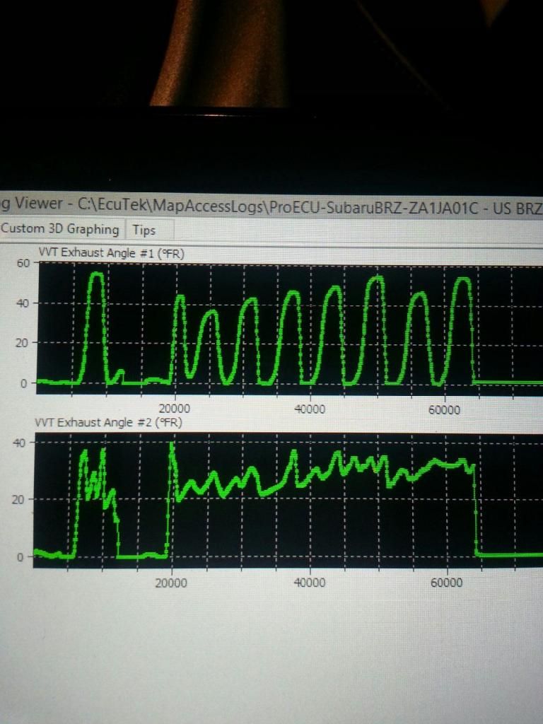

Not to scare people but the cam timing (VVT) failures are a real issue in the FA20 and they are hit and miss. I consider it essentially a silent killer. It happens at random and often without the driver ever knowing its occurring. If you're acute to the issue you can hear it happen in the exhaust note. Most commonly I have found it to be the exhaust cams. The ECU literally looses control of the cams and they can and do float throughout their range out of sync from one another. By the time the CEL is set it has already been doing it for a while. In every instance I have personally worked with, the OCVs have been at fault. Worst part is they all test electrically good so the only way to know is to either know what to listen for ALL the time OR logging the cams always OR toss the cam codes which sadly if that happens it has been already doing it for a while haha. They always have slight deviations but what I am talking about becomes massive deviations haha. To make matters worse Both Toyota and Subaru know about it and there has been zero revisions of any of the suspected components responsible for this sometimes catastrophic issue.
Here is one of them I have logged doing it with NO CEL triggered (eventually it did). Exhaust cam #1 is the floater although exhaust cam #2 was havimg issues as well.
THIS ONE = BAD

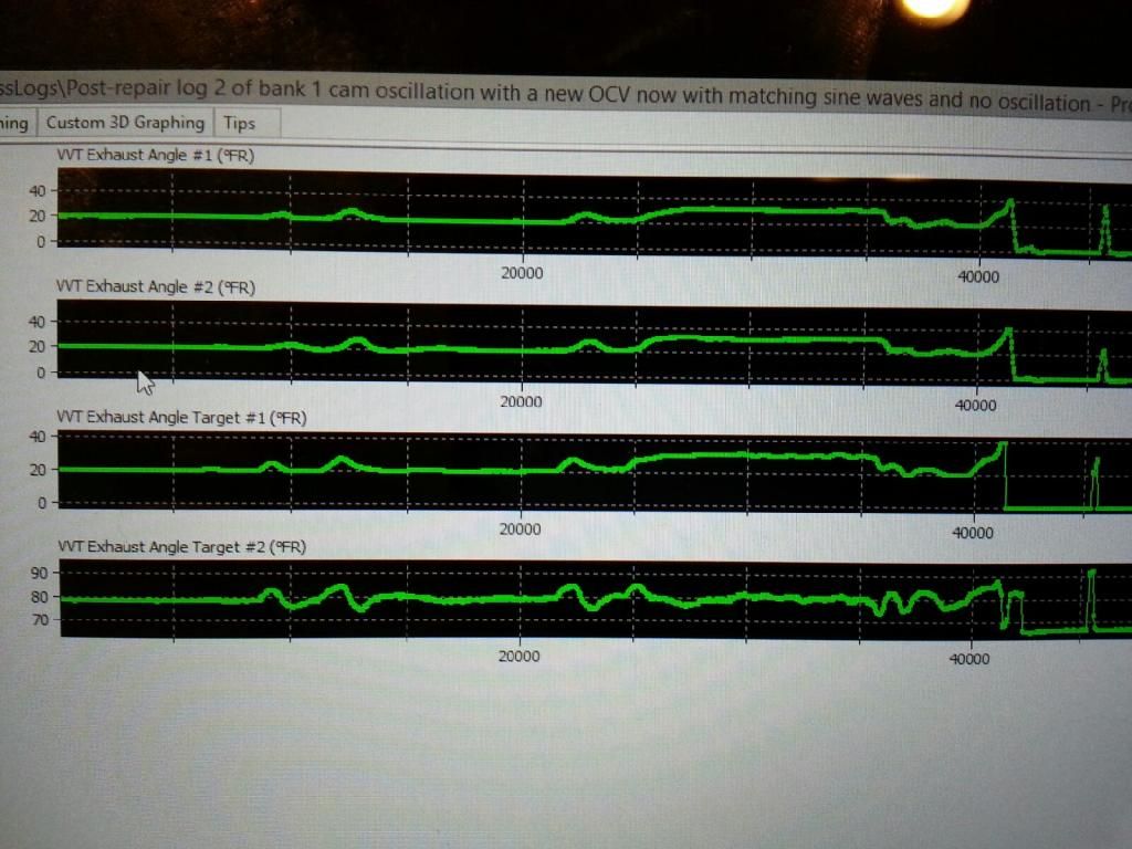

Here is what they should be doing. This is AFTER me making repairs to an FA20 exhibiting the example I logged above.
THIS ONE = GOOD

So what exactly does the exhaust sound like if the VVT is failing? lately, I've noticed my car sounds more UELish although my header is a EL design. we used BRZedit, so I don't think we messed with the VVT.

That is essentially exactly what it sounds like when the VVT is out of sync. The further separation from being in sync the more it will sound like a UEL. Not to say this is what is happening in your case but if it were me I would log your cams asap.
They become most noticeable when idling but it can be heard just cruising along. Under full load and acceleration it's harder to audibly hear, especially because it can sometimes come and then go very quickly. This can happen both intermittently or constantly.

Thanks for the reply, this is concerning. The UEL like sound is only when accelerating from a stop on very low rpm. Cruising, and after the initial acceleration from stop, it sounds like a normal EL.
I am going back to my shop to plot some shit. My correction on the AFR while idling, it seems to vary depending on if I have my AC/Fan blowing but it is around 14 and 16. It actually varies a lot. This car does funky things when the heat/cool fans are on. When I turn off the fans, it idles smooth as butter.
If the VVT is going out, is that something you can fix with a tune? Or does replacing it fix the issue? It seems like the issue will come back if only replacing the VVT from OEM..
