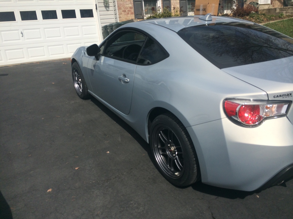

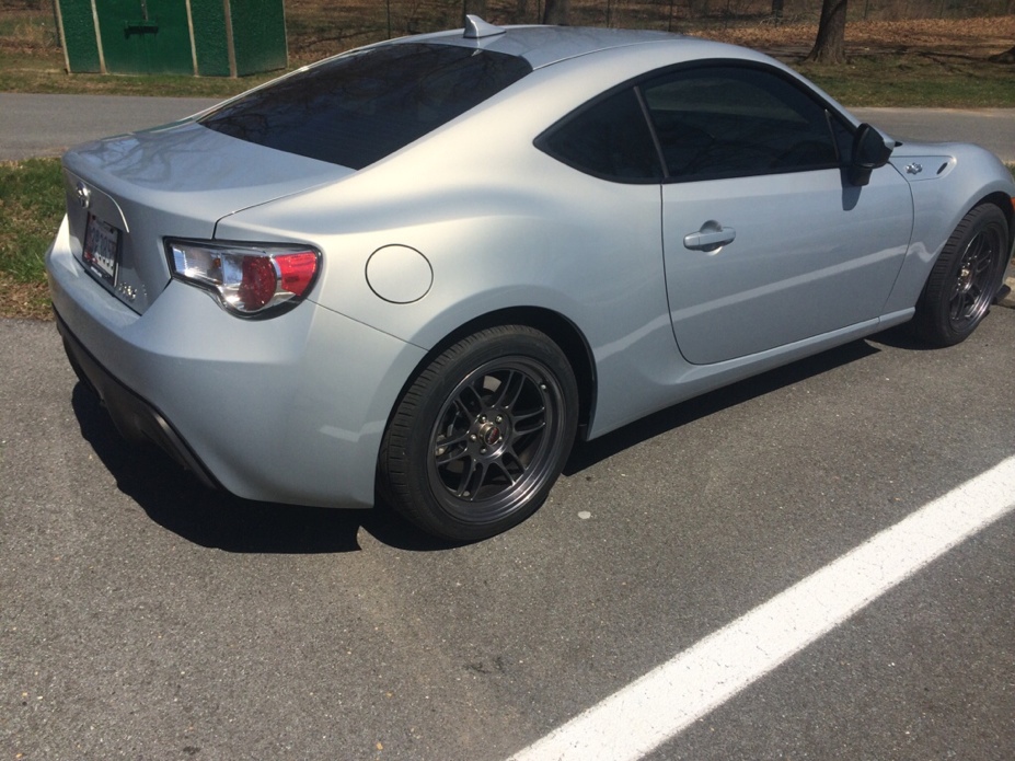

Originally Posted by Gillams View Post
Attachment 73990Attachment 73992
did you put spacers? any rubbing?
Attachment 72754Attachment 72755
I'll take some more later. They are gunmetal.
245/40/17 Looking awesome. Thanks Gillams for the image
