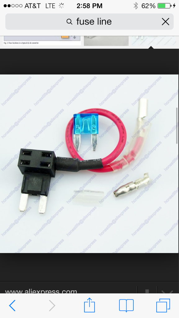

Easiest way. Use one of these and tap into the fuse box. Acc or lights of course.Name:  ImageUploadedByTapatalk1387407598.899500.jpg

Originally Posted by RC51ed View Post
Easiest way. Use one of these and tap into the fuse box. Acc or lights of course.Attachment 60439
When you tap this way, when engine turn off is the line still have power?
Only if you tap in to a fuse that has power all the time. Just choose one that doesn't.
