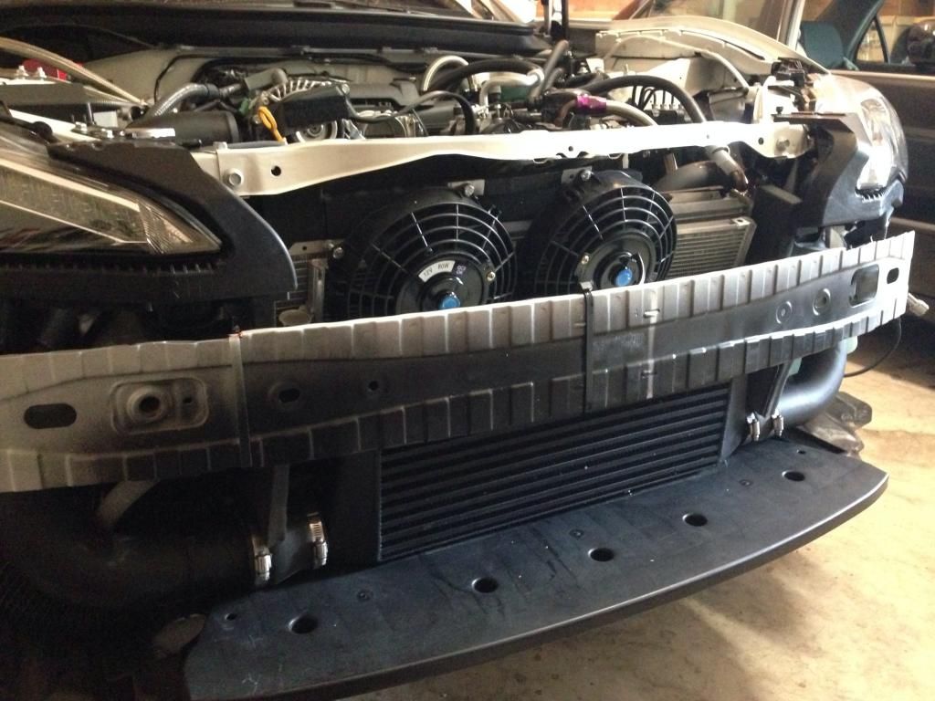

Fun reading this thread. So I took measures into my own hands and executed some ideas onto my currently-down FR-S. Unfortunately, I can't test any validity at the moment (Vortech has my unit).
Here's just a sample pic of two 8" fans wedged perfectly against the bumper beam and condensor. Extra security with 2 bolts along the top edge of the Koyo rad and strapped to each other. It's resting on the fmic atop foam tape. It's wired to a dedicated led switch in the cabin next to the trunk release. I had to rebuild the fans to reduce some noise with additional lube and finer washers.
After the fans, difficult to see, but I added more foam on the top edge of the radiator, existing OEM foam is still there. In theory directing more air in between the condensor and radiator. Then with left over foam, I taped and spray-adhesive strips on the leading sides of the radiator on both sides and above/below the bumper beam. This fun evening of cutting foam was not over, I then made "fins" from more foam and reinforced them wire mesh (desk organizer) and taped/adhesive spray them onto the front face/edge of the radiator. Again, in theory of funneling incoming air to the radiator. And to finish up this lil protect, I drilled holes into the bumper beam foam in hope to allow incoming air to go up the foam vs blocked by it.
With the fans on, I can feel the air going thru the radiator and behind the factory fans - these ~380 cfm each do push a lot of air! With the cost of being loud, I'm sure I can tell when they are on or off (if the blue led switch is not enough of an indicator).
Can't test the validity of this work but I do know what my temps are via Torque app and engine compartments via temp-gun. It'll be another 2 weeks or so before I get my SC back, installed and tuned, before hitting the roads again to test these fans.
I do have have concerns to this project and by which, I don't plan to run them full time. Rather run them during cool-downs be it at the track or spirited driving. More so as helping fans rather than replacement ones.
Nice J! I was thinking about doing something similar. What are your concerns about running them full time?
Hard to say from the picture but make sure the tops of those fans are not just blowing into a cavity. It is recommended to place fans flush onto radiators/condensers so that the air has no choice but to go through the rad/condenser. If there is an open space the air will go up and over the rad/condenser.
Hard to tell yes but I stuffed more padding (denser than the OEM one) above and into the koyo's top rail. Prior to that and relying on the OEM pad, the air would blow right thru and can be felt above the fans (engine bay side). The extra padding adhesive-sprayed into the top rail and onto the OEM padding more or less created more restriction and more air can be felt half way down behind the fans (engine bay side) vs on top of the fans.
Concerns would be that too much air going into and less air exiting the engine bay, another load(s) for my battery to carry w/o computer controlled, noise (then again, I haven't put the bumper back on yet), and these were ~$30 ea from Amazon, I don't think they were really designed to run full time - heck, a little extra lube and replacement of the original washers and snug fit during rebuild reduced their noise. It was an $80 project so I'm expecting $80 worth of good out of them haha
Edit; yea it was more fun to put it together and have it working rather than reading too much and having done nothing at all. The car has been down for 2 weeks and it looks like 2 more weeks - ample time to get bored and do some silly things to it. Right now, it's jacked 14" up on all fours - ample space for me to get under and change a few things haha
