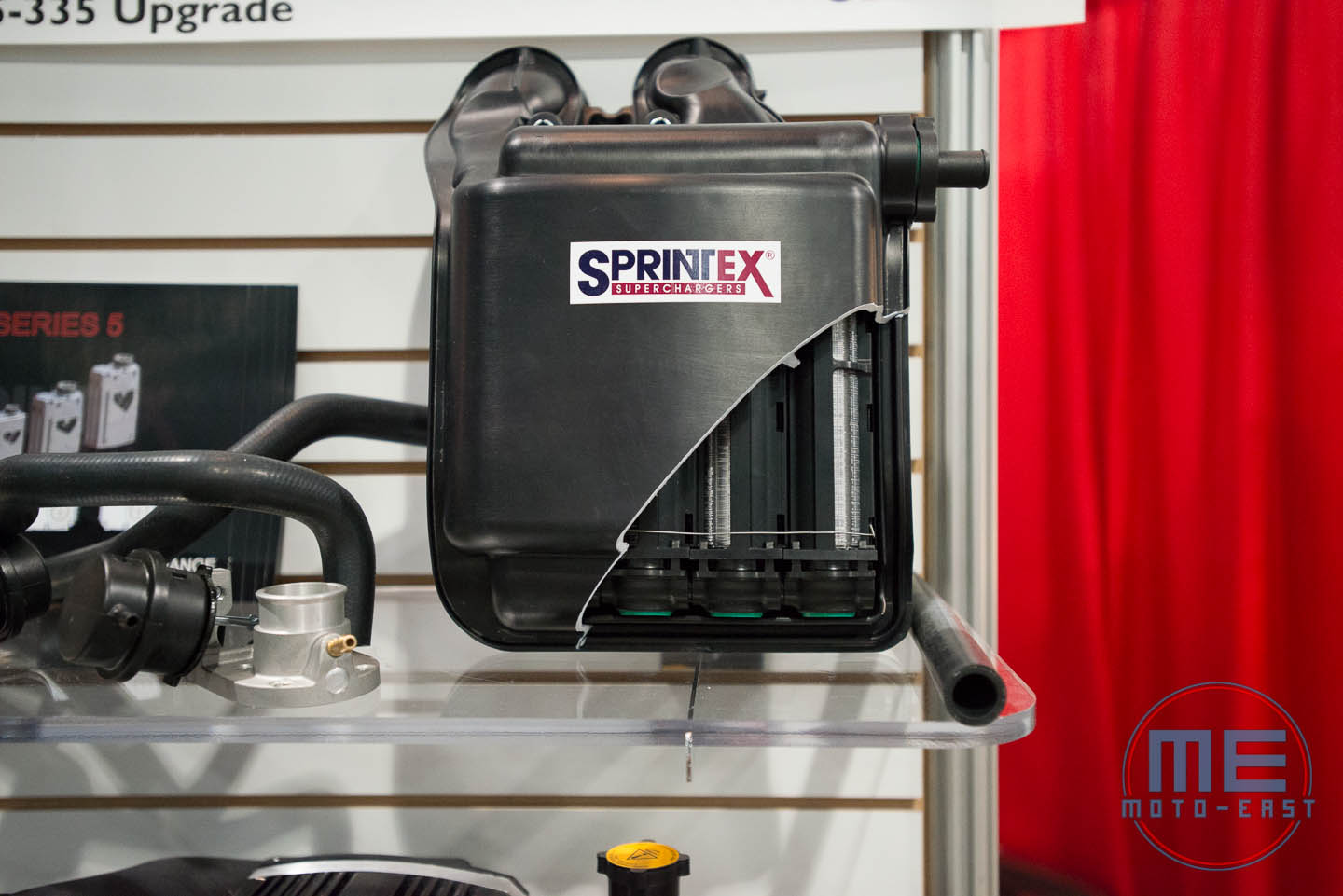

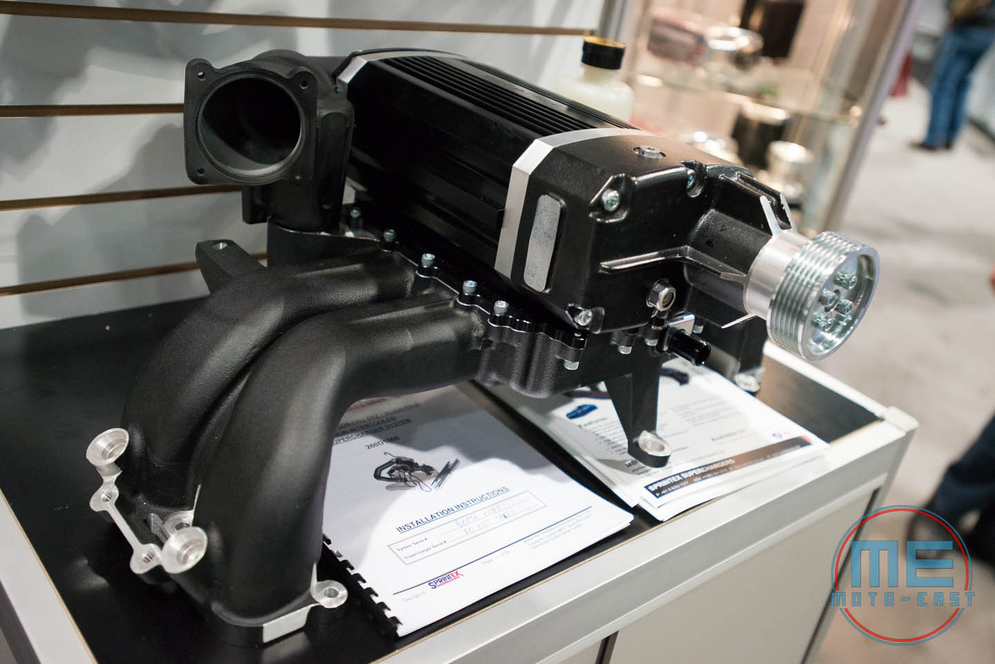

OK so here's the scoop from SEMA
Spent about 10 minutes chatting with the guys from sprintex, and the big blower will be coming out pretty soon. When Innovate sells it will be decided by Innovate, but target date is very early 2014.
The big blower will be good for 400whp, and it will be mostly the same kit except the rear piece.
It will bolt up to the current manifold, same casting.
It will NOT be worthwhile to upgrade because you will be left with an 210 blower with no plenum. This is a bigger hit than resale loss. If you do not have the IC kit especially. But the big blower kit will be quite a bit more expensive than the current...so it will make sense for people who are planning on building motors. Current users don't sweat it; the original kit will carry plenty of resale just by that fact alone.
