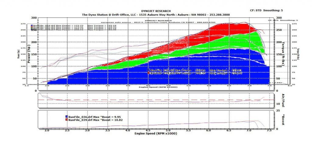

What kind of impact would a UEL or EL header have over stock header using this S/C Kit?
I assume the factory tuned version would not support a header change?
(Also - please assume a aftermarket 3" catback is installed)
Thanks!
A huge impact (increase in power) with a catless header, but yes, you will absolutely need a custom tune. Basically, you can nearly double the gains.
Check out this post.
http://www.ft86club.com/forums/showp...1&postcount=59
A little disingenuous to attribute all of that to the header Mike, c'mon. The combination of a pro-tune and header resulted in the ~100hp gain over as assumed baseline of 175hp peak. The CARB tune gives you what, ~50-60hp? Assume 20hp for each the tune and header - though I would caution that the biggest changes the tune makes will be in the shape of the curve rather than the height of the curve.
I'm saying the combination of the header AND tune. You can't just throw on the header; the CARB tune will probably freak out and go into limp from the drastic change in VE.
The CARB tune was good for a 70whp gain. From 4500-6500 RPM, the HKS header + tune doubled the gains. After 6500, the gains plateau on the header + tune, and below 4500, the torque dip elimination overshadows the gains from the HKS header + tune.
Don't focus too much on peak numbers. You're only at the peak for an instant. Rather, focus on the overall power gain.
As I said, the shape of the curve is more important - people may misunderstand "double the gain omg 140hp w000t sttrippers and cooooke!" you know?

I threw together a quick pic...
For those that aren't sure what they're looking at
Blue area = stock power
Green area = Gains from Jackson Racing SC + CARB tune, everything else stock
Red area = Gains beyond the CARB tune with a HKS EL header, catless front pipe, and custom tune.
Do you have a bigger picture, hard to read the numbers.
How about the original without the colors?
Still terrible, sorry.

you guys are lazy!
Here's the JR original.
