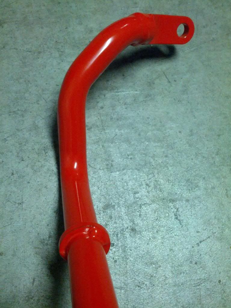

Does anyone have specs or feedback on the Tanabe 22mm hollow front bar? I'm looking for an alternative to the Strano unit due to fit and availability issues. I also like that the Tanabe bar uses antiwalking tabs. Thank you!

I emailed them for technical specs and went ahead and ordered one. I'll update this post with data when I get it. Thanks for the useful list!
2/11update from tanabe-usa
Japan got back to us with some information regarding the front and rear Tanabe stabilizer bars. The stiffness rate for the Front is 205% and the Rear is 235% stiffer compared to Japan OEM. The difference OEM between*for the US and Japan is in the rear. The front outside diameter of the bars are the same but for the rear Japan is 14mm thick compared to the U.S. which is 13mm thick.

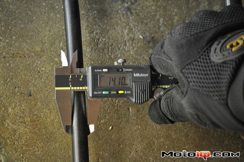

First post Updated. But am not sure about the size of the US rear sway bar... Who can confirm? I have my sway bar but its difficulty to measure without the correct instrument...
14mm appears to be the correct diameter for the US rear sway bar.
Source: http://www.motoiq.com/MagazineArticl...ne-Dodger.aspx
