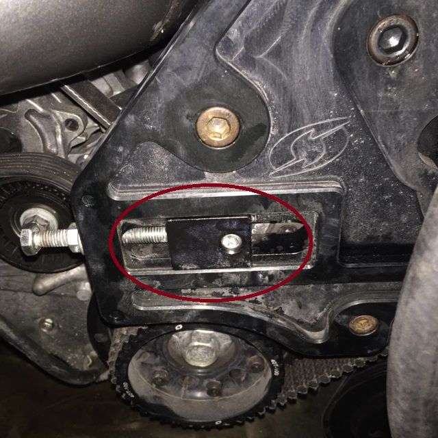

Weird, I thought that just held the pulley in place and didn't have anything to do with tension?

I found that when I have problems removing a particular part, it almost always helps to loosen or dislodge something else that that part is connected to first.

Yep! That's it there. I loosened both bolts but it wouldn't move. Maybe there's some debris in there that I didn't notice. Anyone else have this issue?
I used a hammer to get it to budge, just barely. I loosened it completely and then put a bunch of grease on the track to see if it helps for next time.
