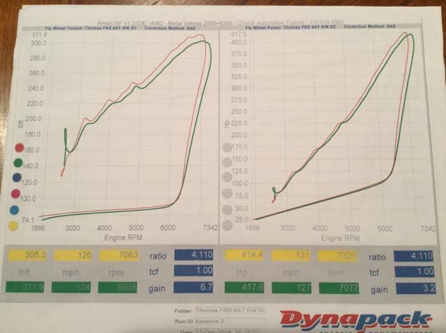

Originally Posted by D_Thissen View Post
Awesome numbers! Let's see the dyno graph
best i can do until i get a scan of the sheet
Not too shabby at all. Those automatics seem to be holding up quite well for the level of power we're seeing through them.

in an automatic? wow, that's nice.
