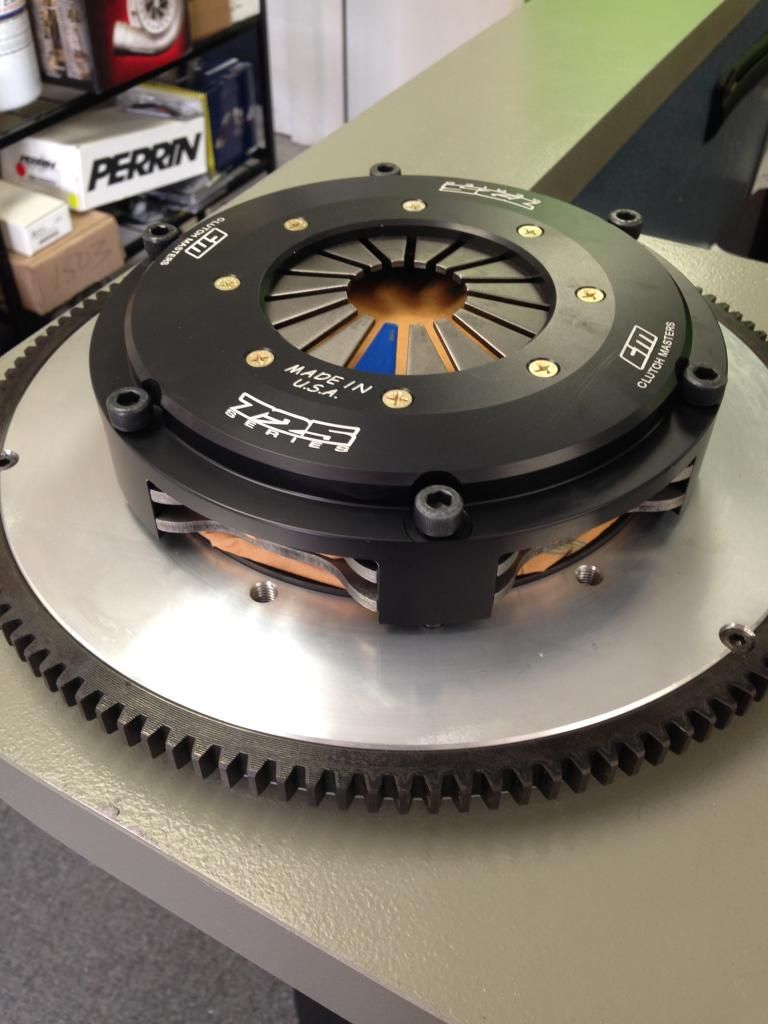

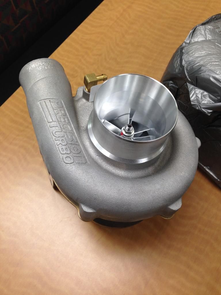

Turbo kit, radiator with fans and shroud, down pipe wrap is here. Stock motor is at full blown and heads are being installed on the built short block. Doing fererra valve springs and retainers as well now. Maybe shipping before the end of the week/early next. Clutch masters fx725 twin disk clutch is ordered and being built by CM currently
