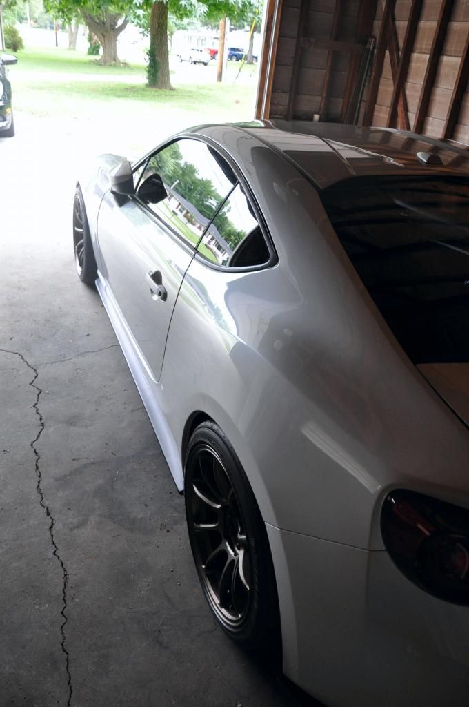

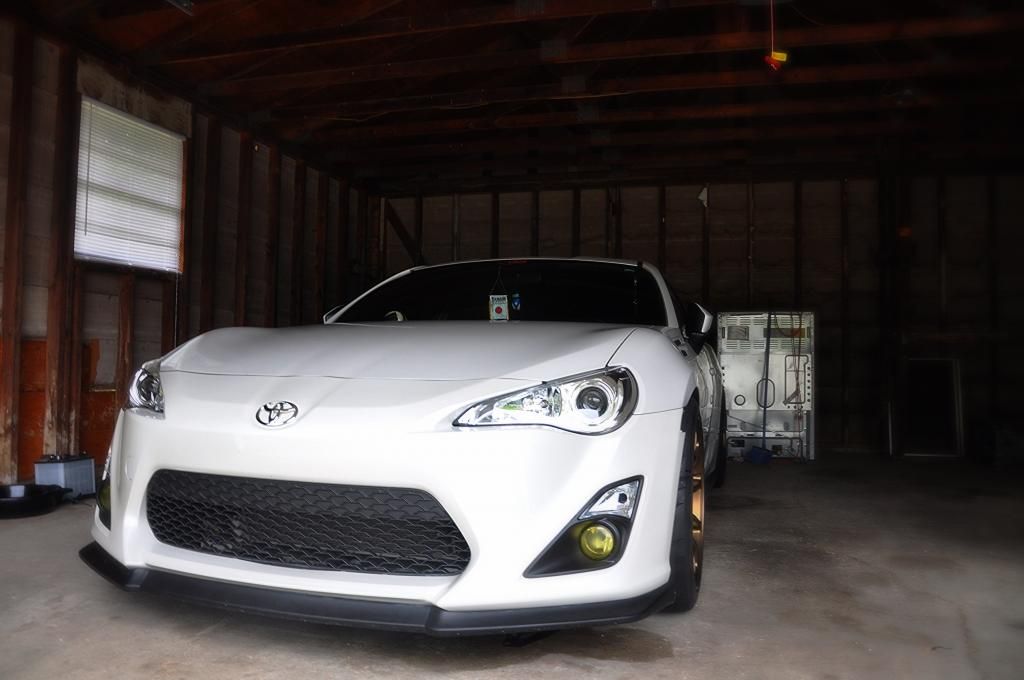

Car looks so odd without the FMIC

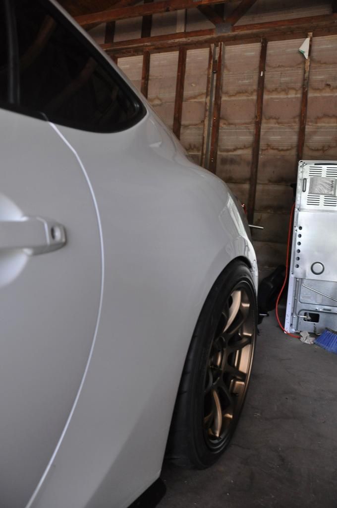

Rear fitment, going to do a little more work to the quarters
And yes, that's hearing protection that stays in my car lol

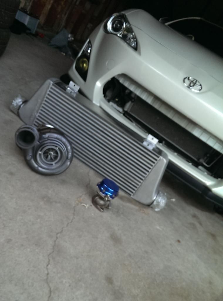

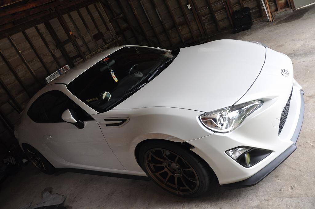

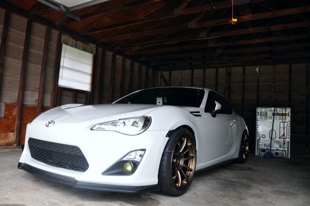

Well some more has changed...

about your plate....
I thought all Supras were FR. Just playing...
car looks amazing. bold choice to do this swap and try and keep it low budget. it's members like you that help pave the way for others who want something similar in the future. thank you.

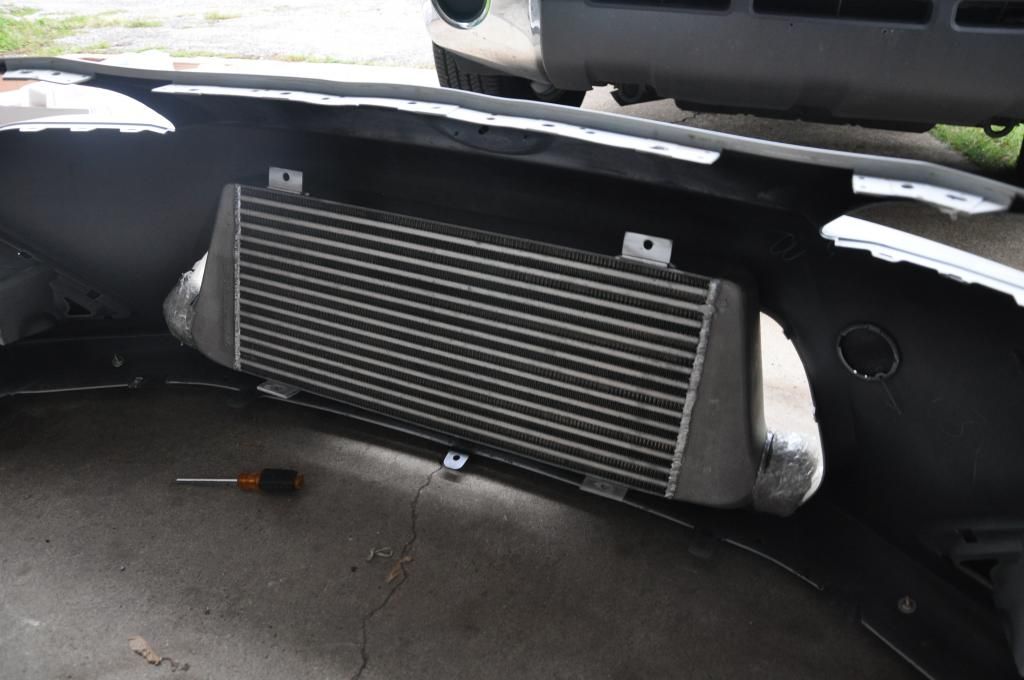

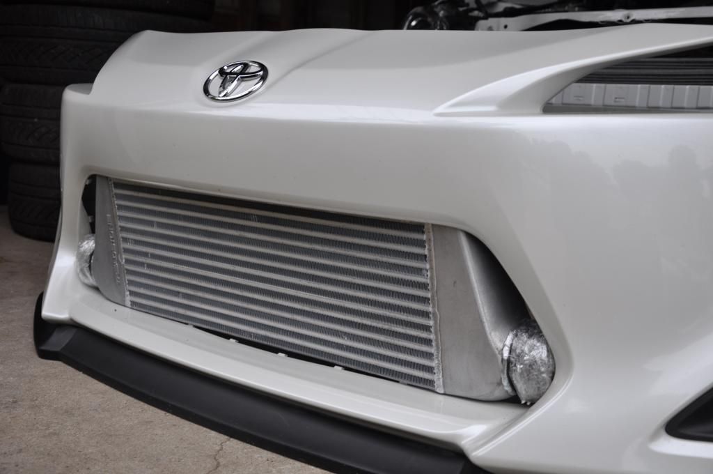

Got bored today and wanted to see how much the Treadstone TR10 filled the bumper opening. I'm 85% content with how much it filled, which I'll live with as it's was pretty cheap and scored a decent deal on it brand new. Keep in mind when it's actually mounted the bumper cover will be trimmed and the core will sit quite a bit lower and further inward, literally just wedged it into the cover to see how much of the length of the opening it took.

Overall satisfied with the quality of the core, cast end tanks are pretty nice.
