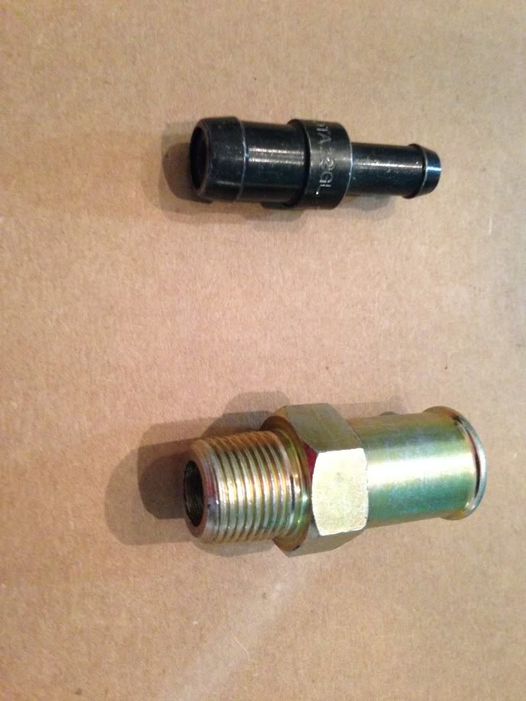

Originally Posted by Draco_PR23 View Post
The first one is the upgraded PCV valve and the second will replace the factory PCV in the block. I just had a look at it and I see some very small threads at the beginning, I think you kinda see it in the pic.
Thanks!
Yeah....thats pretty much exactly how mine looked. Alost no thread at the beginning. This will not work, you probably got the same one as me from a batch of bad castings/threadings. Contact Paul and have him send you a new one. The correct one should look just like any other threaded bolt, and the threads should be thicker through-out.
Thanks!
i see i see. I only was offered the first pcv choice when i bought mine, so power to you for getting a block fitting. I eliminated mine, due to it leaking boost, and causing my oil reservoir to puke at times. I'd suggest as seen above, requesting a new one, and in the mean time venting it.
