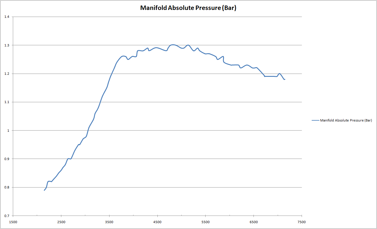

I will be doing some more runs and logs tomorrow and compare mine to yours, will post it up tomorrow after pulling it in and plotting in excel....just got my new 8psi actuator installed today (thanks paul @AVOturboworld).
Trying to figure out this new actuator, settings, etc...new thread about it. Bar to PSI Questions
Here is a boost plot to compare. Cannot figure out how to convert the map reading to be in psi....any help?
Thought i had it figured out....(MAP)1.3*14.5-14.5= 4.35psi!!??thats not right...

Yeah, so mine seems to drop about 1.7psi. This whole conversion thing is still throwing me off, but you look at my boost plot and you will see...
1.3bar (18.85psi) max then tapers down to 1.18bar(17.11psi) so about a 1.7psi drop. Keep in mind, i believe my map sensor reading is off, as i am not pushing 19psi! At least i hope not! Really need to figure out the conversion, or get my 3-bar map sensor configured in ecutek properly.

The MAP sensor is reading your ambient air pressure + the boost. Sea level, that was be 1 bar - 15psi. But if you are in Denver, CO, the atmospheric pressure is 12.1 psi. So your boost on top of that, if it's 18.85 psi, is about +6.85psi. That's what it's reading at the manifold, and not necessarily what it would read with a boost gauge attached. A boost gauge is generally going to be a bit more accurate.
This is why cars have MAP sensors, of course, so they can compensate for the changes in altitude. One of the reasons it was important to test in Utah was the fact we were at 5000-6000 feet for so long (and at speed! Gotta love an 80mph speed limit).
