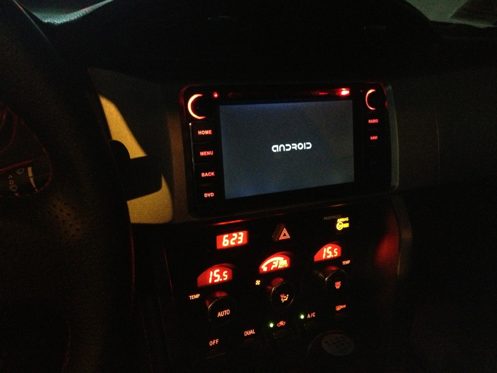

Back on topic - I'm now a card-carrying member of the 600nm+ club. My LEDs are 630nm. Still a smidge too red I think, but not enough to do anything about. @Trap63 - yours were 625, right? How do yours compare? Too red or orange?
so, This is my swap!Name:  ImageUploadedByTapatalk1375720974.894514.jpg
Size:  132.1 KBName:  ImageUploadedByTapatalk1375720990.165959.jpg
Sent by iPhone with Tapatalk

so, This is my swap!Attachment 46839Attachment 46840
Nice. Well done.
No scary moments during soldering where you thought - "damn, hope that still works"?
