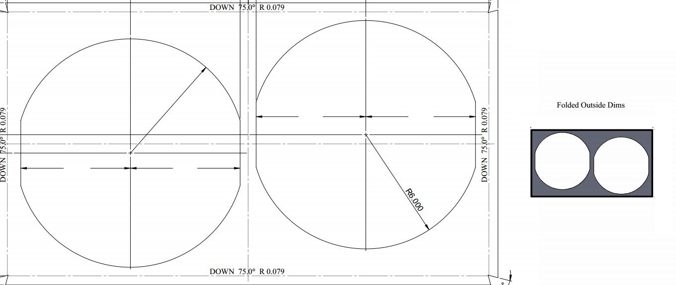

We've had shrouds drawn up but just didn't have time to get to it. These will be in process soon.

You the man LJ. I will test fit one for you.
