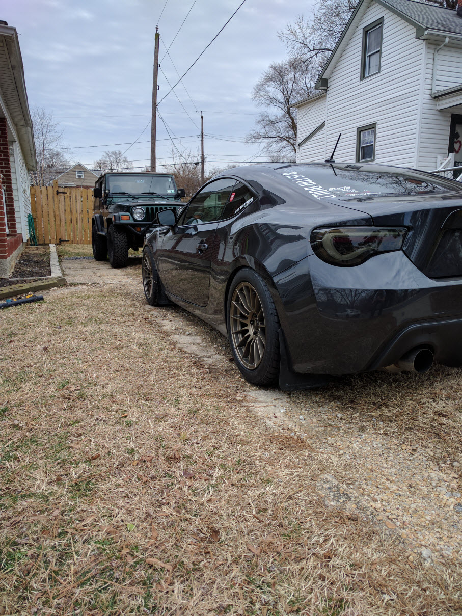

Never posted an image on here, so not sure if this will work. However, Not sure how much lower than stock I am, never measured the difference. Hopefully the pictures can illustrate properly. Really just looking for info on which area of the rear bumper "tab" people generally trim, because I believe that is where I am rubbing.
Thanks!

@Wpomp The tire you have installed is the wrong size. It is about 1" too tall. 255/40 is the better size.
What suspension do you have installed?
You will need to raise the car or trim the tab quite a bit. It will likely need be trimmed to the point where the push tab is no longer there and the bumper would be held on from the other clips and from the "L" part of the bumper would be "hooked" on. But if you pull on the bumper, the "L" part of the bumper will be easily pulled off as the tab is no longer there.
1. raise car
2. change tires
3. trim bumper or let tires auto trim bumper by rubbing

Welp, Thats a big mistake on my part. Guess I shall see about a return if I can, and if not, live with the mistake. Raising the car was something I was going to do a bit of anyway, so that wouldn't be a big deal. I have ST coilovers on the car at the moment.
Thank you for the clarification on the bumper tab trimming, I appreciate the explanation!

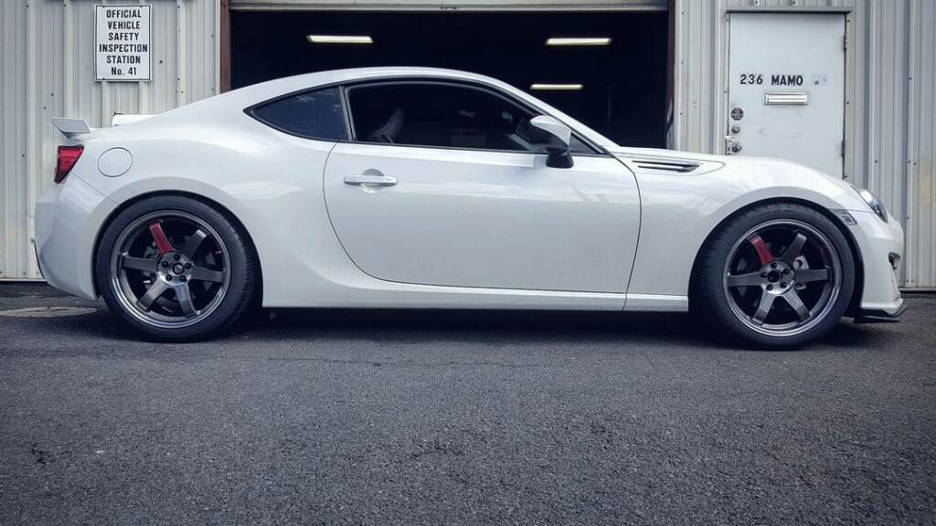

Got my wheels and tires mounted this past weekend 18x9.5 +40 with 265 35 18 MPSS 😀 #meatyftw

Any rubbing issues? And any chance you know your alignment specs?
Looks great!

Thanks! Haven't had a chance to really drive the car much. Only drove it around in a parking lot, but when I did go over a bump the rear bumper tab rubbed so I used a dremel to shave it down. At full lock the tire rubs the fender liner. Also rolled the front fender near the sidemarker just to be safe. Alignment right now is set at -1.8 camber front and back and toe is set to
.08 front and back.

Thanks for the info, gives some insight into my setup. I'm trying to fit an 18x10 +39 F and +44 R and it seems very mixed on going with a 255 vs. 265 depending on the tire, but your setup is fairly close to mine
