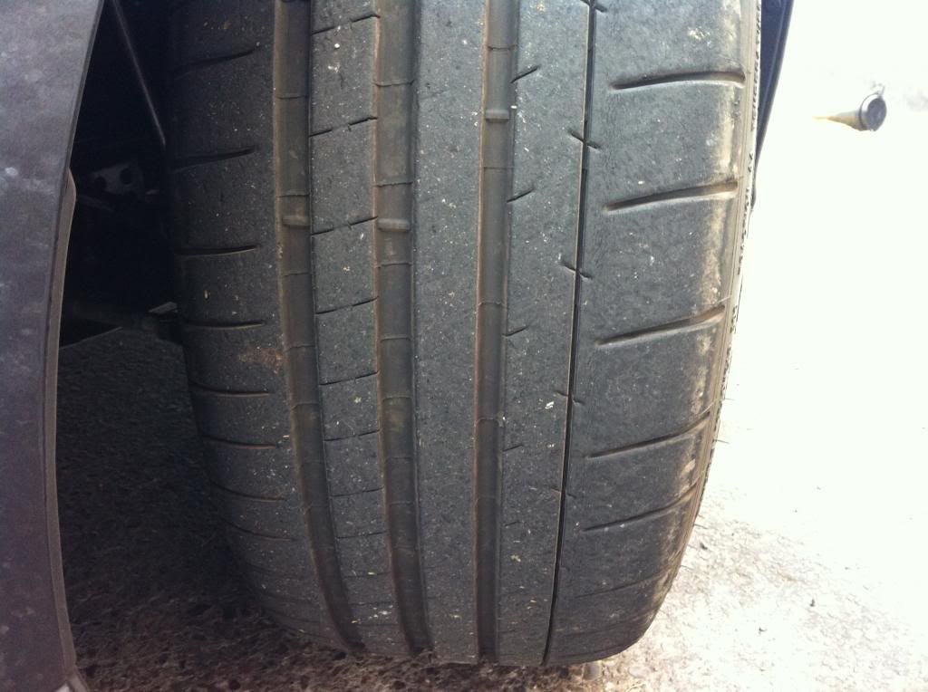

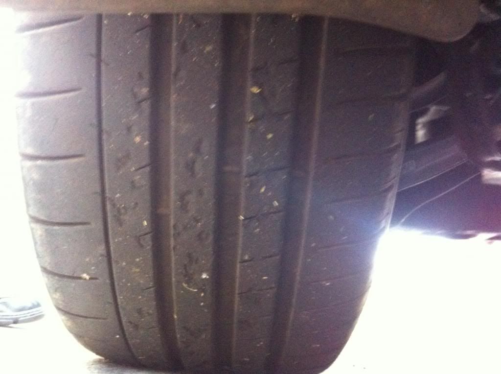

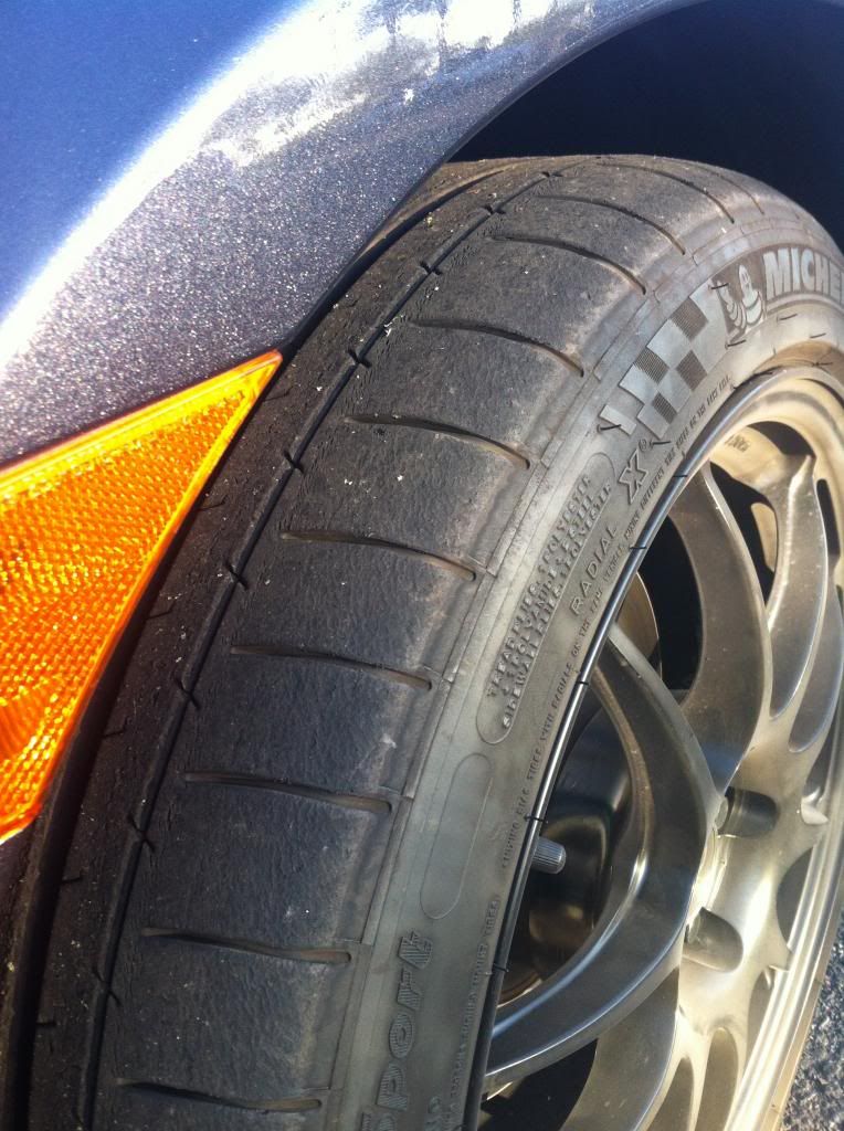

on the topic of tire pressures:
I ran two days of HPDE1 and 2 last weekend, and on both days ran 36psi on Michelin PSS 225/45-17 on 17x8 rims.
On Day 1 I got some chunking on the rears, and not much on the fronts.
On Day 2 I don't think I got worse chunking, but definitely was running faster laps.
Should I spend the first lap or two really trying to heat the tires before I rip ass on them?
Higher or lower cold pressure?
Day 1 HPDE1 FRONT
Day 1 HPDE1 REAR
Day 2 HPDE2 FRONT
Day 2 HPDE2 REAR

@kavanagh: You're just overheating that rear period! You need a little more camber as well, but the pressure is fairly close.
Thanks Mike! I'm grabbing a set of camber bolts from a local forum member.
I think I've been reading that 1.5* negative front camber is decent for street/track?

It's a good start, but you'll want more if you keep tracking. Camber doesn't wear the tires too much for street use unless you do a TON of highway driving.
