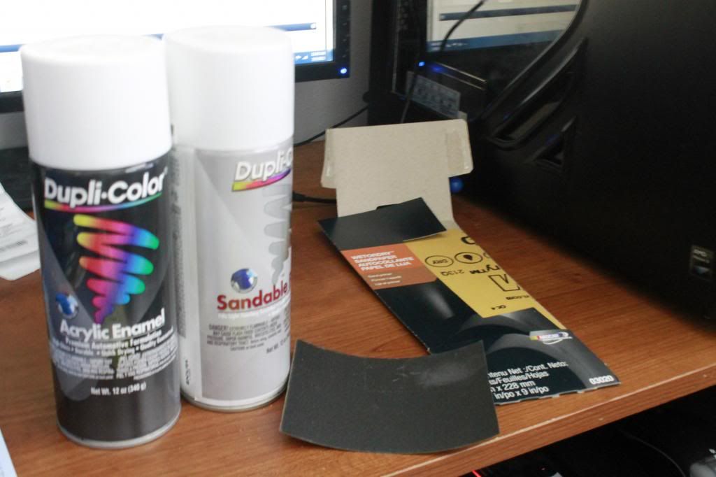

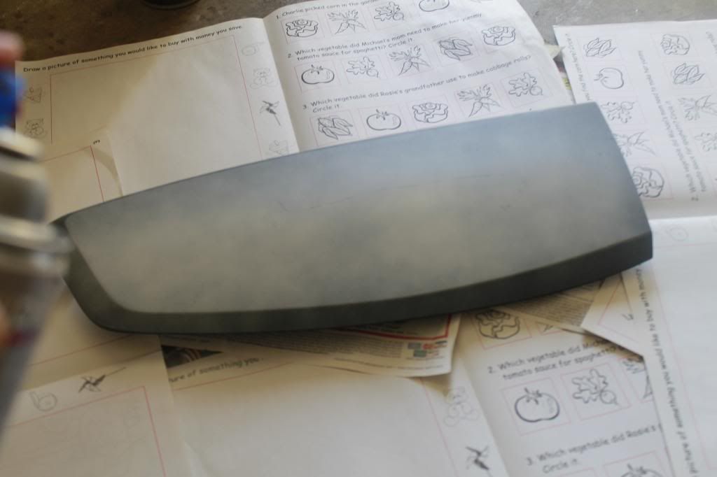

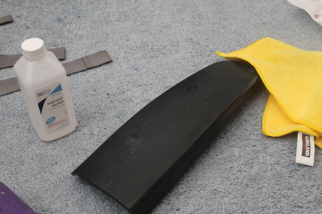

I wiped it with IPA
The spray and sandable primer I got from O'reily and 600 grit wet or dry sand paper.
The left side sprayed.
The right side half sprayed

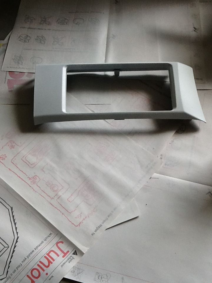

I finally put the finishing touches on my dash. I'm thinking of moving it up and over to the right a tad.
