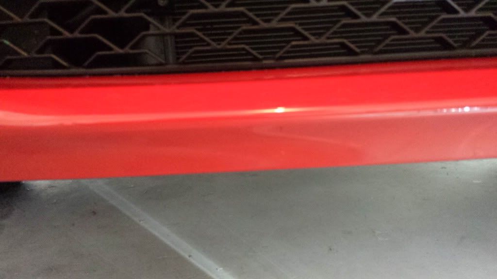

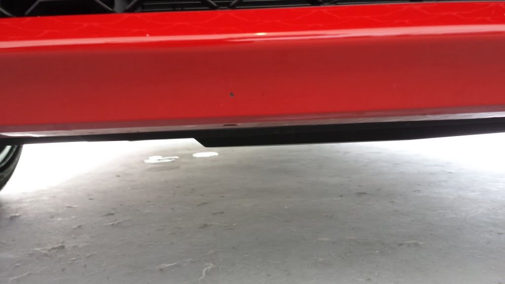

Okay here is my result. I hard a hard time getting the camera to focus once the chip was covered up. Not a bad job. Worth $50? I'm not so sure. I did cover up a few smaller dings with more success.
