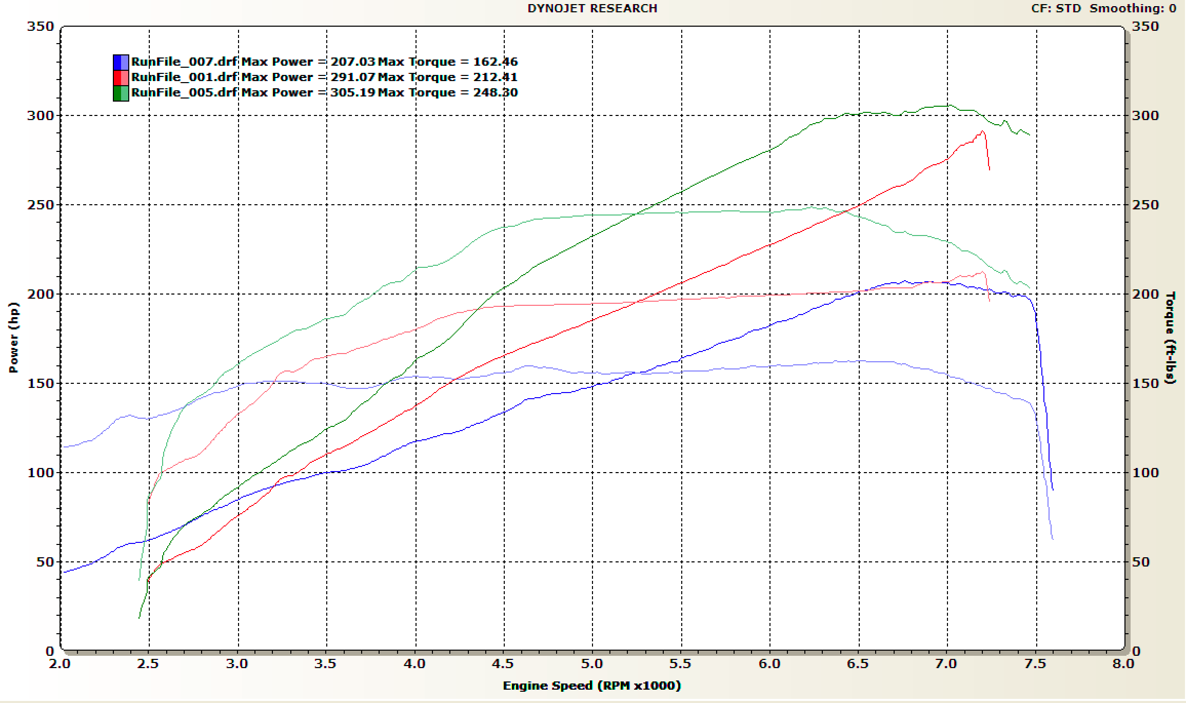

Originally Posted by Sportsguy83 View Post
Who's tuning his car? What software? Ecutek RaceRom 7 or earlier? Speed Density? E85? What PSI?
How do I determine the version? I think it was the old one.
And yes, Speed Density + E85. 6.2 psi was fine, but 9.2 psi leaned out horribly, according to the Ecutek log (up to 17:1). Can be seen on the dyno chart too, where torque falls off after 6000 RPM. Red = 6.2 psi, Green = 9.2 psi, Blue = NA
A those PSI your issue should be proper fuel pump install.
and Sportsguy83 is right...
make sure u have the right amount of o rings too...
who's your tuner?

Do you see the fuel pressure drop at the time it goes lean in the logs?
That's clear sign of problem with FP.
Ooh, good point. Let me check that tonight. I'll check the wire routing too. Thanks!
Do you mean the direct injectors' fuel pressure? That one seems to be stable throughout:
