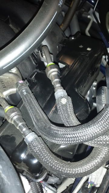

I'm bored so I'm poking around the engine bay... question?
Is it legal to remove the metal bracket on the driver side of the engine? It serves no other purpose than as a cover for some fuel injection components.
It's the one that looks similar to the ecu mount.. but on the other side.
take a pic. It 'shouldn't' be a issue. but let me see what we are looking at before I say yay or nay..
Bill
I'm trying to attach the picture but tapatalk isn't uploading it for some reason.

Here.
It's quite heavy for its relatively meaningless job. I'd say close to 5 lbs.
Here.
I am going to say 'NAY'..
"I. Upper engine shields made of plastic material, the purpose of which is to hide mechanical components in the engine compartment, may be removed if they have a solely aesthetic and/or acoustic function."
Since its a Gov. Mandated Safety item (Fuel rail protection).. and its metal, not Plastic, Like the intake cover on the top... I would not remove it.
Bill
